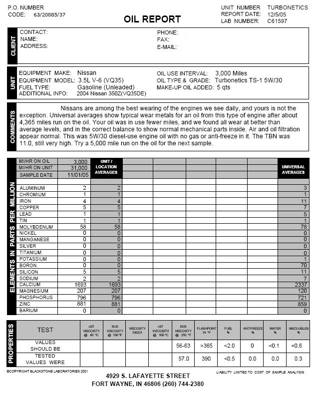

i've been using Turbonetics TS-1 oil since my kit went on. Its been great for me... Attached is an oil analysis after 11,000 boosted miles. The TBN rating is of note. Typical TBN number for synthetic oil is 8 or 9 when BRAND NEW. This number typically drops after use. Mine was still an 11 after 3,000 miles on this oil. TBN being the amount of additive still active in the oil. Also attaching Turbonetics fact sheet on their oil..

Pretty good report, MIA. For us hot climate people 10-40 for the summer and 5-30 for the winter. Some even go higher such as 20-50. The new Mobil1 extended performance has so many antiwear additives and stabilizers that it often causes foaming. Regular Mobil1, Amsoil or Castrol Syntec all will work fine. I did a Blackstone of my 1st built motor after 2k miles(not counting the 200mile breakin) and on 10-40 the numbers were great considering how much it was beat on.
Yeah I was kinda wondering about switching to something heavier but I ran that oil all through summer even at the track and never had a problem. I'm going to do an oil analysis with every change this summer and see what comes back. I'll be pushing a bit more HP then too. Surprisingly this is the exact same oil Turbonetics used in their Drag Barrier Celica. Not a one off or "based on" but according to the GM the EXACT same formula...
