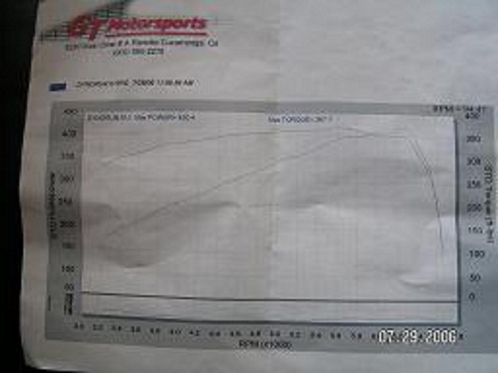

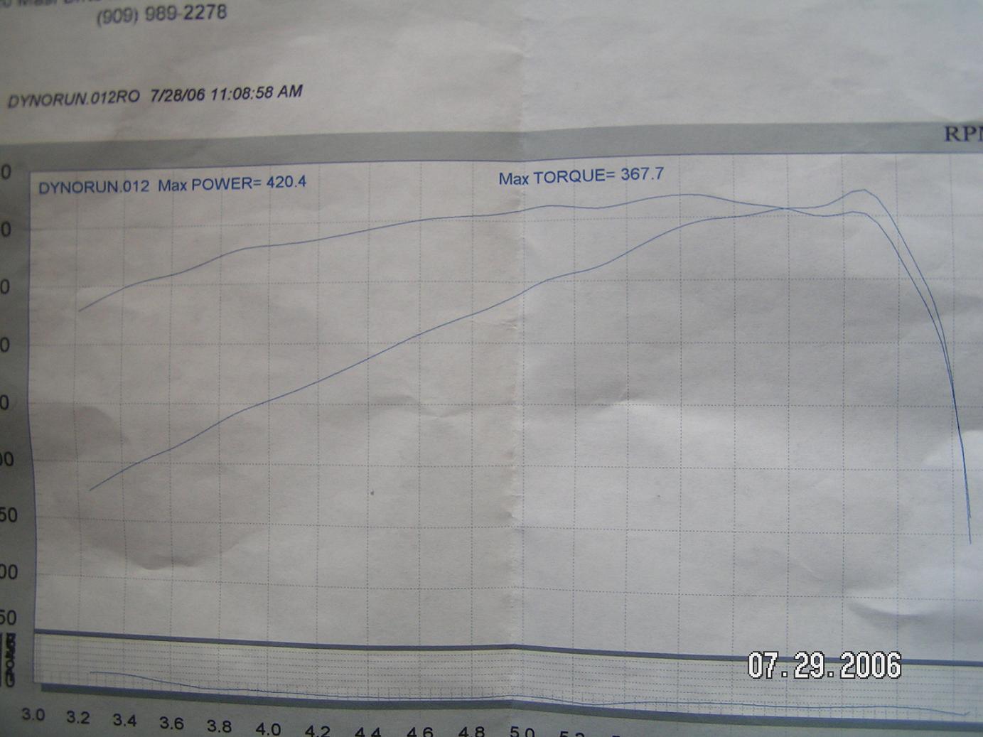

this is on all stock internals with aps 3.5" downpipe, 3" exhaust, and aps plenum, still running strong after 1,000 miles
420 rwhp
367 rwtrq
right now im at 8psi!!!

Old Aug 21, 2006 | 06:58 PM
20"makavelli's Avatar
20"makavelli
Posts: 321
From: Valencia, CA
clearer pic
Old Aug 21, 2006 | 06:59 PM
