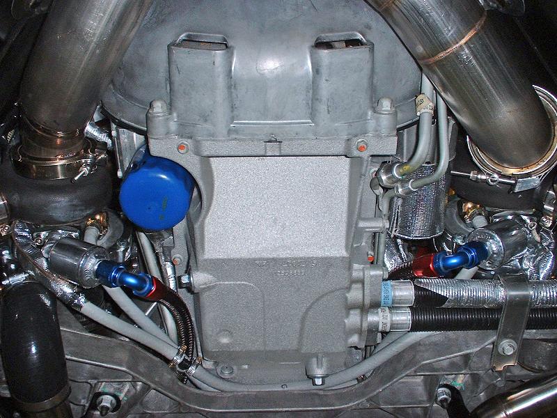

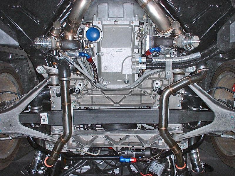

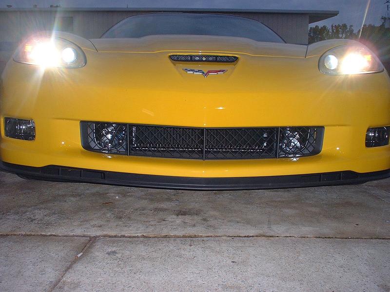

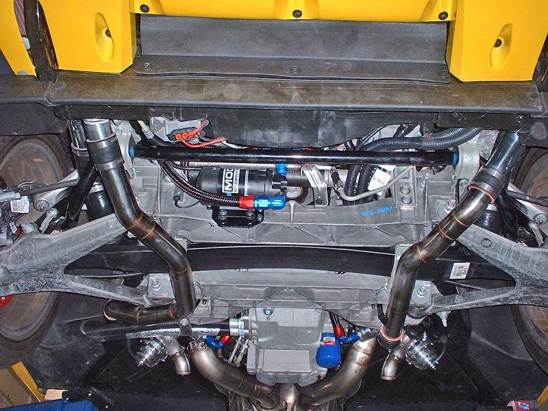

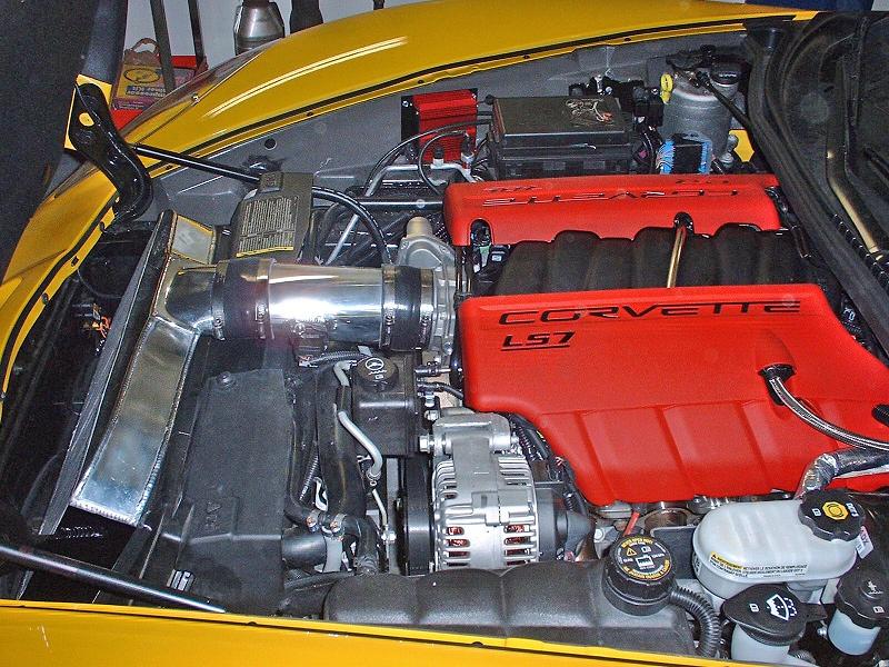

ok here are the new finished pics. you can see the detail, notice the aluminim cannisters for oil return reservoirs, all custom made, all earls pro lines and fittings, check out how the ext wgs are welded onto the housings, the custom ic and tb charge pipe, mocal sump pump, simple amazing work. quick rundown, 2 gt35rs, 2 ic cores welded together, 2 50mm tial bovs, 2 44mm tial wastegates, lots of ss piping, lots of silicone couplers, all vband clamps, custom equal length headers, etc.
wow, i just shat a little bit!! nice work.

beautiful setup. amazing attention to detail... well accept for being able to work on the car now... that will be a pain in the ***.
