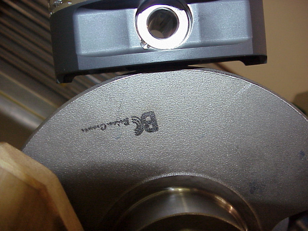

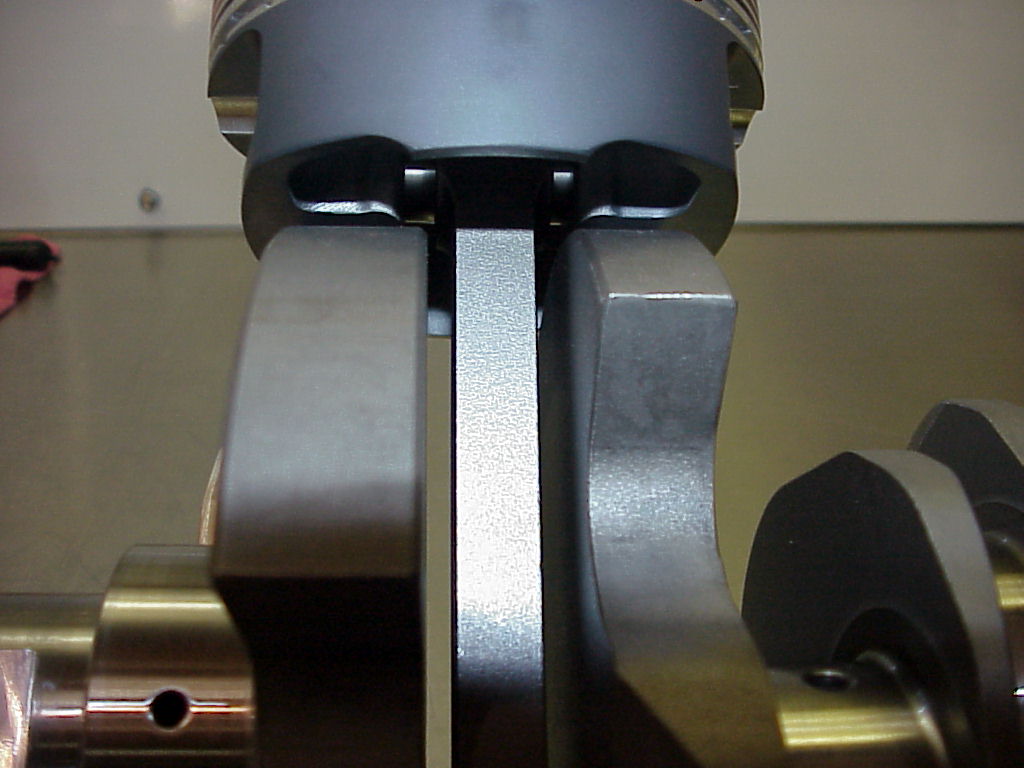

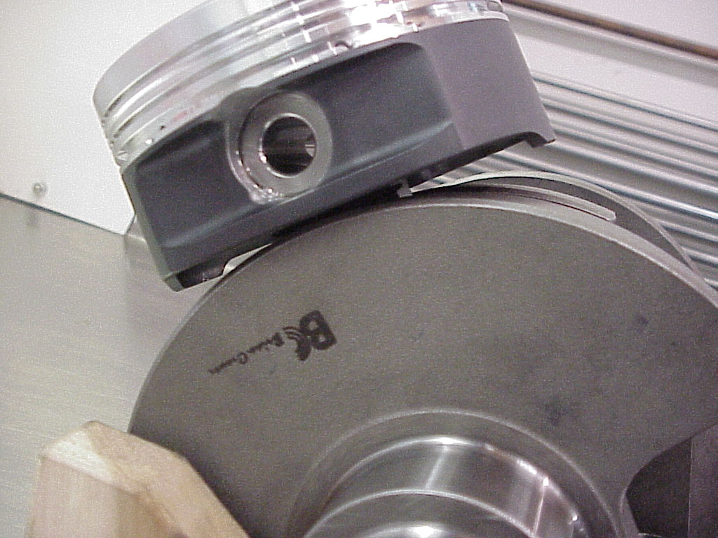

we did have a chance to examine and test fit the brian crower kit in the vq and I hate to tell you this , it does not work or fit for many reasons
1- crank hit the block (clearance issue)
2-pistons bind and strike the crank (design issue)
3-no oilier (completly eliminated due to poor design)
4-not enough engineering went into this STROKER kit otherwise you should not have all these problems .
all this info is 100% factual , this kit was supposed to be installed in a sema vehicle 2 weeks ago and let me tell you there were a lot of disappointed people to say the least .

A picture is worth a thousand words, so much for just going by "family reputation".
