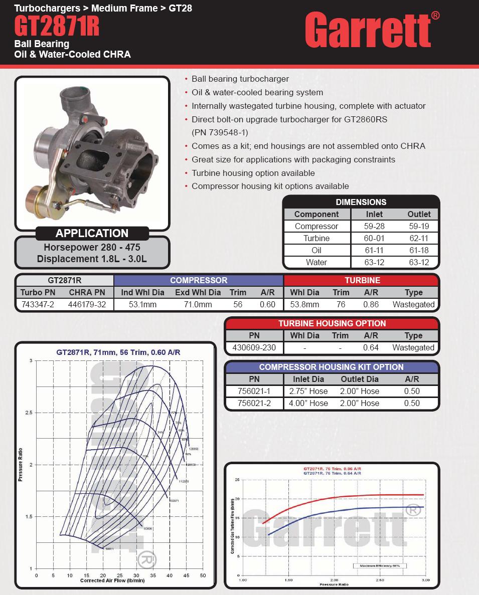

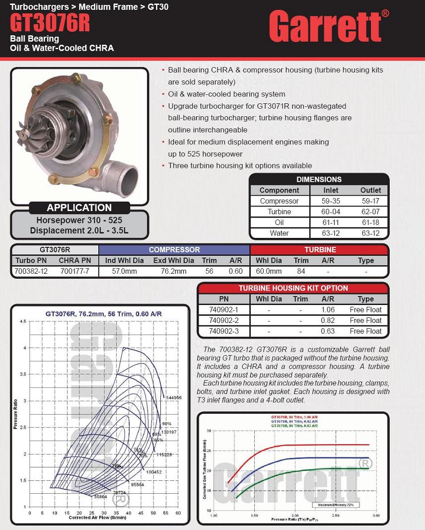

You did mean GT2871Rs right? It could be a GT3076R but theres no way its a 2871R. All three configs of that unit flow less than 50 lb/min. The only 2871 are that comes close is the 56 trim unit. But that only flows to 46-47 lb/min. Compressor map attached. APS claims over 50 lb/min of flow each:
Originally Posted by APS Website
Without doubt, everything about the APS Extreme Twin Turbo System says BIG! Big turbochargers, big intercooling, big fuel system, big down pipes - Big Power - over 50 lb/min mass air flow from each turbocharger.
The smallest unit Garret makes that flows 50 lb/min or more is the GT3076R. Not even the GT2876R or 3071R will come close... GT3076R map attached also..
thanx for the info. From the specs it does look like the extreme kit has to flow more than that...
It would have to or the APS power numbers are way off. I have a feeling the regular twin kit is some form of 2871R. But the Extreme kit has to be 3076Rs or larger...

Hmm I don't see any turbos in Garretts catalog with the same A/R config on the compressor and turbine side that flows over 50 lb/min. They could be using a smaller compressor housing and machining it out but that would be weird. it would increase the A/R of the compressor no doubt. Still the highest flowin GT28XXR compressor Garrett makes is only efficient to 48 lb/min. Not over 50. If someone measured the inducer and major diameter we would know for sure.

Originally Posted by Gunmetal-Z
Are we now talking about the Extreme kit? If someone could please clarify thanks.
We actually have two discussions. The charts I posted are what I thought were the standard kit and my guess on the Extreme kit compressors. But the housings don't match any out of box config Garrett has. Not that they aren't the units as they could have new or custom compressor housings. Although the housings appear to be out of box Garrett units..
