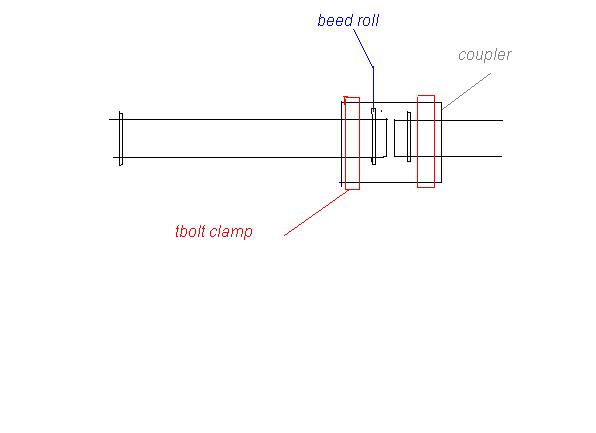

You need to make sure the tbolt clamps are tightened above/below the beed rolls on the charge piping. see attached ghetto art work.

Yeah your right (tbolt vs v band) The beads BARELY reach in some cases. Guuess I know what i'm doing this weekend!
Sean

Yeah you need to adjust the piping a bit sometimes to get the beed rolls to be even across the system. Its a pain but once its right theres no issues at all. Thats the whole point of the bead rolls and t bolt clamps.

Its really important to keep everything loose tilll the final routing and tightning ---On the silicons, make sure u have a good bite and an oil free silicon to pipe connection--- That means even oil from ur fingers.

you may have to readjust several of the pipes to get evwerything aligned.
When I installed my kit, I had plenty of room to make sure that all the t-bolt clamps were beyond the bead on the pipe. somewhere maybe you have a misadjusted pipe that is throwing off the fitment along the line.
