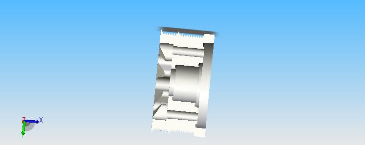

Crank Pulley:
As mentioned above the crank pulley will be a harmonically dampened design consisting of a hub and shell with o-rings similar to the ATI super damper. The 10-rib section will be towards the inside and the 6-rib section for the alternator and PS will be moved out slightly. Right now I am still considering one design option for the pulley shell. I am considering putting three dowel pins in the outer rim in order to use it for a RPM signal for a possible cable throttle body switch with stand alone ECU. Since I am utilizing MasterCam and turning centers with live tooling this is still an option which would be nice if I choose to switch the Q45 TB and something like the Megasquirt standalone (if they have coil on plug control yet). The shell will be aluminum and the hub will be made out of an alloy steel. The shell will be attached via 8 shoulder bolts and dowel pinned for location reasons.
I had considered a cog setup using a forth axis in a machining center. However, after further research I decided that it was not worth the hassle associated with it since there are so many different tooth profiles avalible and I am unsure of what I would need for a belt length. I contacted gates and worked with them to come up with a solution and even worked with York Industries to get some belts custom made but the cost was not worth the effort or the gain.
The pulley will obviously be balanced also.

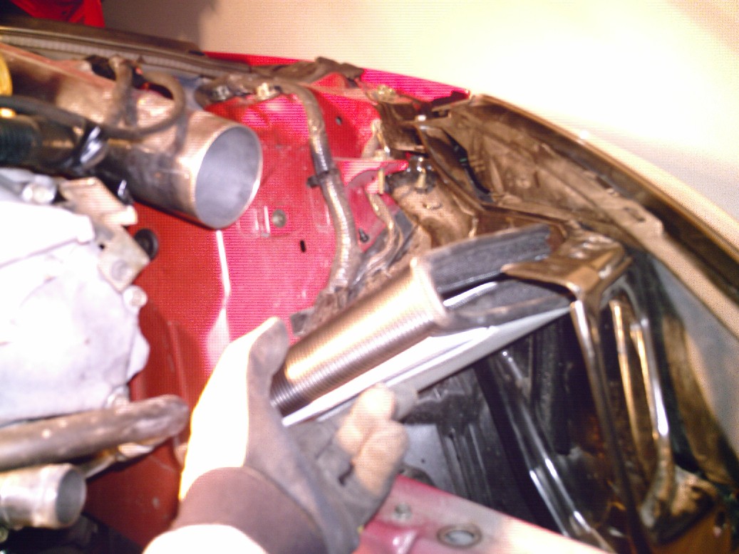

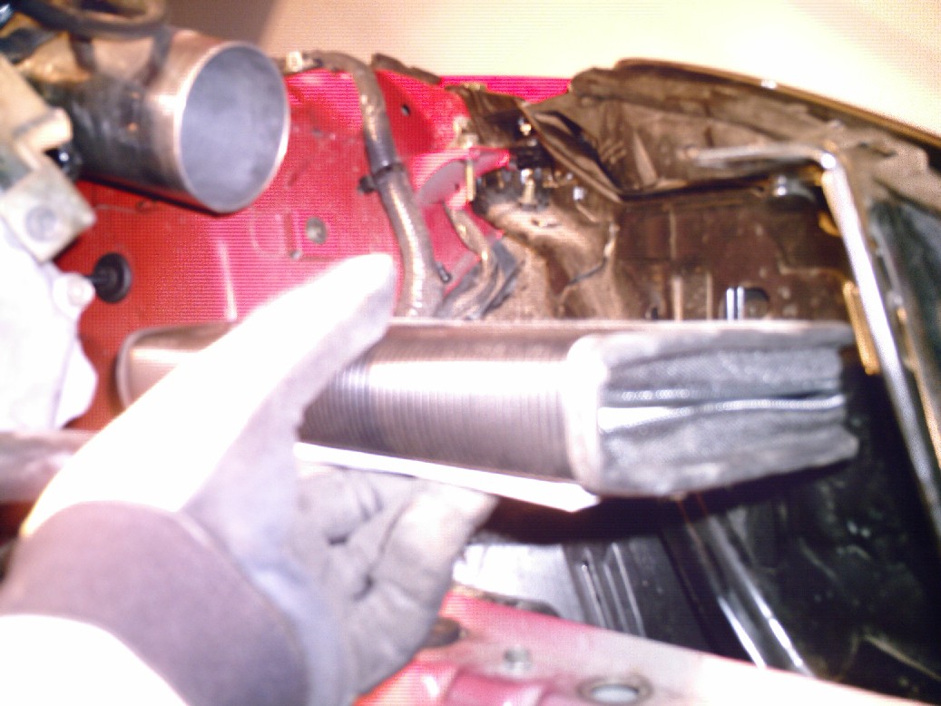

The intercooler will be a simple air-to-water intercooler utilizing a Bell core with custom end tanks. While air-to-air is more common and can be just as effective the idea is that with the air-to-water intercooler I will be able to reduce pressure drop between the inlet and the outlet due to the smaller space which can hopefully allow me to create some more power at a lower boost level.

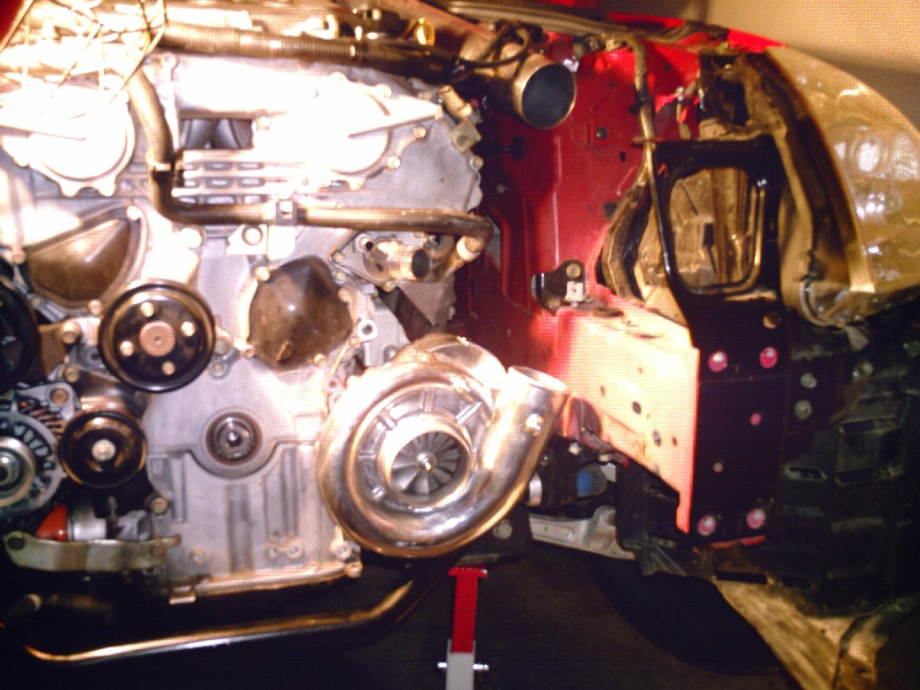

Headunit:
The V2 headunit will be as mentioned lubricated by a standalone oil system in order to reduce temperatures. The intake will run under the driver side unibody frame structure into the front driver side of the bumper.

Below I have attached some pictures of where the supercharger will be roughly mounted and where the core of the intercooler will be mounter. As for where the intercooler core will be mounter I have two options and I will post both. One is at a 45degree angle and one is horizontal. Please excuse the use of the 350z owners manual as an example but it is something that should give you a rough estimate of core size (but not as thick).
Here are some pictures and drawings
