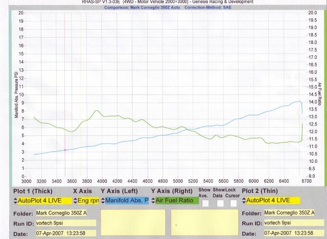

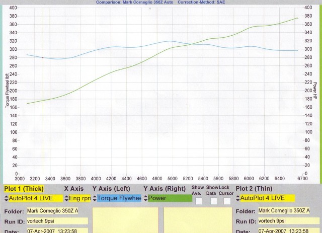

When we first put on the Vortech, we had completely stock exhaust. We used the stock Vortech pulley. It performed ok, but we were looking for more..
We went with high-flow cats, Greddy Evo2 cat-back, and the 3.12 Vortech pulley, tuned by Tuan @ GRD yesterday. Still using the Split Second box.
Results - 378 rwhp, 320 tq SAE on a Dynapack dyno. This is a 2004 Touring 5AT.
The car pulls amazing (especially in the 27 degree Chicago weather)
Thanks to the GRD crew.

He couldn't complete a full before run, it was way too lean. When we first got the car (brand new completely stock), it put down 220 on a dynojet. Tuan said a stock 04 5AT usual puts down around 210 on their Dynapack.
With the stock exhaust and pulley, we had 318 on Sharif's I believe.
Hard to compare different dyno's on different days.

True..My first dyno was on a Mustang dyno . At the time I had already done headers , RT cats , plenum , and the STillen exhaust . It just made 220whp . I believe the Mustang dyno to probably be the lowest reading dyno . Ive heard of stock AT5 cars doing 190whp on it .
