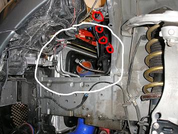

Here ya go . The red circles are the 4 bolts that needed to be removed . The white circle is where the blower drops down and comes out . You can get to the oil line and the return oil line from there easily .

Alright, ill try that tonight, it would be easier. Do you have any problems getting the oil return hose back on?

Once you get the front wheel well off . You will see how easy things are to get to . I would try what I said earilier . Remove 3 of them and try to move the blower around to get to that bolt . You might want to take out the bolt all the way and put a drop of Locktite on it .
