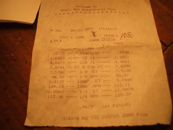

What I said was a GT3582 would flow more then a 60-1 but not more then a 62-1 which is much easier to switch to. The 62-1 compressor will easily outflow the GT3582 and its a simple compressor wheel swap with some minor compressor housing work. Of course if you wanted to swap and you are going for bigger power why not step up to a GT-K 550 or GT-K 650. They will both easily outflow a 60-1, 62-1, or GT3582 and except for the GT-K 650 being a T4 turbine the GT-K 550 would be a fairly easy replacement. The F1 Stage V turbine wheel has already been used in place of the standard Dtage V on one car (Reggie's G35 sedan) so I know the turbine housing can be machined to fit that wheel. You see the Z turbine housing (on this kit I mean) is a bit different then your standard tangential T3 turbine housing. Its a Kokelen housing and as such its dimensions present a unique challgenge. Regardless since we now know the F1 Stage V wheel will fit in it its now just a matter og getting the GT-K 550 compressor section fitted to it. Reggie had planned to do this but ran out of time on trying to get everything to fit into his schedule. What I would personally do if it was my car was order a GT-K 550 with the Z specific turbine housing and then let the shop near you re-work the intake piping (the compressor section on the GT-K 550 is different) to make it all work. Of course if you are looking for more then 600 WHP then I'd go with the GT-K 650. The 650 is a T4 turbine so you'll need to have the shop cut off the T3 turbine flange and weld on a T4 turbine replacement. The turbine discharge is a 3" vband so you'll also need them to change the downpipe for you and since you are going to change things you could have them shoe horn a full 3" downpipe all the way back from the 3" vband. That setup should be good for over 600 WHP... Consequently a DSM guy on the Turbonetics Owners Club just installed a GT-K 550 on his car and is pretty impressed with it so far. Here's his posts on the matter and a quick video he took:
Originally Posted by dsmdan
My GT-K has some crazy *** top end guys! I picked up over 32mph in the back 1/8th.

Very NICE!!!
