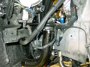

I don't know if this will help you or not, but this is what I found when I lost my power - of course, it showed up in a lack of boost. I ended up replacing this piece of the TN kit with a high pressure hose.
