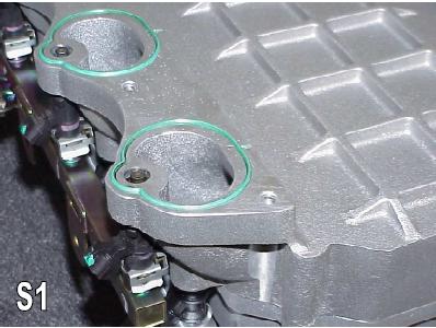

Secondary injection has been used on OEM supercars for years. It definately has its purpose. What would be neat, is if someone fabricated a new lower collector, with additional ports for a second set of 6 injectors, and a supplimental fuel rail. This would provide the best distribution of fuel, and is exactly how the OEM's do it.

MIAPLAYA's Avatar
MIAPLAYA
Posts: 11,373
From: Escondido
Thats a very interesting approach and its actually used by Stillen on the Nissan Titan Supercharger kit. Although they use 8 subinjectors for that. Kinda hard to tell but pic attached.
Attached Thumbnails Secondary Injection w/ EU + Greddy TT-stillensubinjectors.jpg
That would be staged injection not AIC like this setup.
Staged injection is used and widely accepted due to the fact that the location of the secondary injectors are calculated and designed into the plentium. Not grafted on as a second thought.
