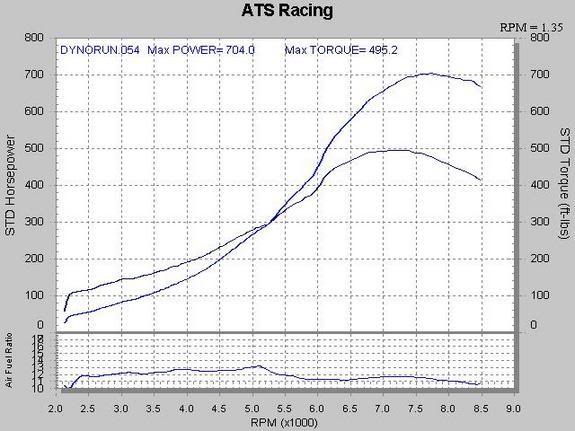

its one thing i love about the VQ .. it gives a great power band like a V8 ..
sure on a 4 cyl like this MR2 dyno you need 9000+ rpms
but we make so much good power.. why?
