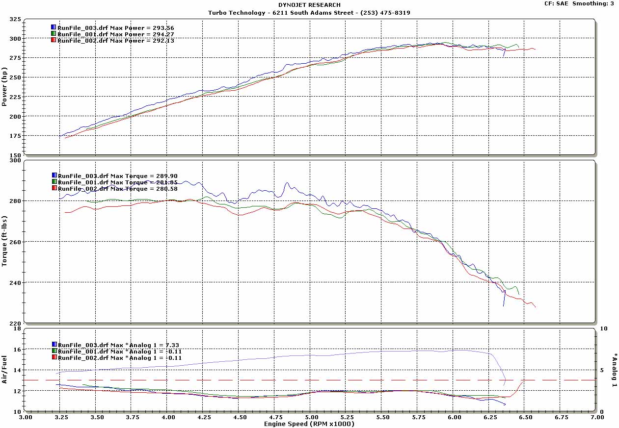

This from a Stillen stage 4...

Anybody see anything telling in the chart or text? Not really sure what I am looking at but it actually looks pretty smooth, just not making any power...

That sucks Hate to say it but the high flow cats and exhaust are whats killing you. The stillen kit HATES breathing mods. Highest Hp I've seen from a stillen kit was with the car stock besides the blower. And even still the car only made 307 on the stage 4

hmm, maybe it could use some more timing??
I have never seen an FI car make less HP on more breathing mods.
That is kind poor though.
What are the details of the flash?
What was taken for timing
AFR looks decent. Can take out a c hair of fuel in the mid range a little ,but not enuff to make any power. So no diff will be seen.

I'm no expert, but all of the stillen stage 4 dyno's that I have seen have been between 290 and 307 WHP. That's pretty typical, right? Do you have a dyno showing your WHP before the SC?
Its roughly a 20% WHP gain over stock. Expensive if you look at $/HP, but very reliable and the least likely FI to cause your motor to blow chunks.

A little low, but the Stillen SC kits produce some of the lowest numbers around. A customer shipped a Stillen kit to us, and asked us to install it. it made 270whp (5AT) on our dyno dynamics with bone stock intake and exhaust. The AF ratio was actually very good, out of the box.
