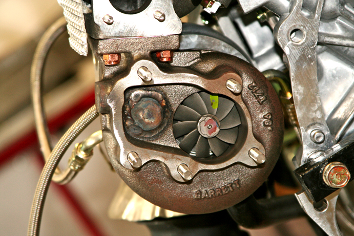

Old Aug 21, 2007 | 06:12 PM
tig488's Avatar
tig488
Posts: 4,660
From: bama
Originally Posted by SMS Tuner
I do know and than you for the advice but, i believe they use the same turbo outlet which means that the Extreme turbos can work with internal waste gates. i just need some of the more experience guys here in the forum to ether prove me wrong and ask me to shut my mouth or tell me i can do it.
you cannot use the Extreme turbos unless you change the turbine housings. i believe APS welds the puck shut for the Extreme kit, so an internal wastegate setup is not feasible. and why the hell would you want to run internal wastegates for a high boost setup.
see what i mean?
Old Aug 22, 2007 | 12:36 AM
SMS Tuner's Avatar
SMS Tuner
Joined: Nov 2005
Posts: 57
From: planet earth
Thank you for the tip and the picture. as for the internal waste gate, we have few cars in the shop making up to 700 WHP on internal regulated turbos. Not VQ35 though. but that doesn't mean it is better than the external waste gate at all. it is just going to be very expansive to by the extreme turbos, Manifolds, Down Pipe, and Waste gate from APS.
