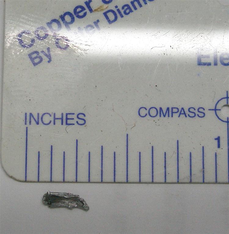

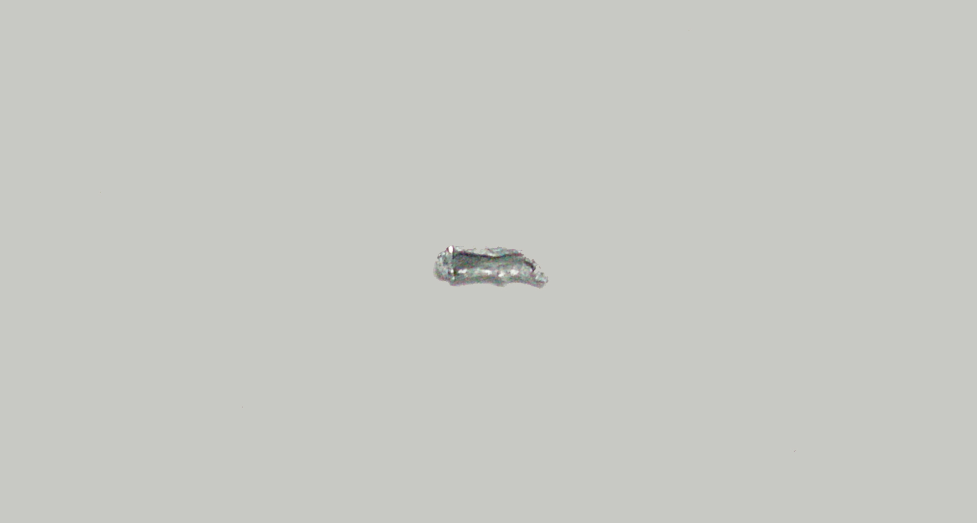

Well, the inspection has begun. I have taken the tubing apart back to the throttle body and the supercharger is out (see the last post of 'Vortech Eats Itself'). The next task is to get the charge-cooler out and the plenum apart.
But,......... we found a little something at the throttle plate (we called it the 'butterfly valve', back in the day) that I thought needed to be presented immediately. On the top of the plate, held in place by a light film of oil, was a small fragment of the blade (see pictures). There was NO sign of damage to the plate itself and looking back into the plenum I could NOT see any other fragments. The rest of the intake tubing and the MAF were clear. What we originally thought were scrapings along the discharge tube of the supercharger were actually molding lines, so all clear there. Still no sign of the rest of the missing blade.
I guess this supports Jeremy's assertion that things CAN get through the intercooler/charge-cooler and back into the engine. The next step will be to blow air back through the charge-cooler, rinse it with water and then pressure test it (or say to hell with it and just replace it.......). And then the plenum.........
We will keep you posted on developments.

You might have lucked out. You will need to use a solvent as a flush, water wont cut it. Naptha works well as does kerosene or Diesel. I would pop the plenum and clean/inspect and fish around the intake area with a magnet. A compression test can be run without the plenum in place as can of course, Leak-down. Check your plugs to see if they tell you a story...Color/Chips/bent electrode. also a flashlight will show if the piston top has fresh scars on it.

Its a bummer I was was wrong about the small bits making it through the intercooler . By your description of what happened , you ran it for a while after it happened and that may have given the metal bits time enough to make it through every thing .

just clean it and pressure test it, it will cost you $3 in parts from lowes, misc pvc fittings, etc. it should be fine.

I hope that this is the only bit of metal that got this far and that by wedging the throttle plate open it is the cause of the P2101 ECU code (I just went through the 2006 service manual and this appears to be the most likely cause for this code). We will know more tomorrow when we get the plenum apart and will post the results in this thread. Until then, fingers crossed

I took mine apart this weekend, had metal shavings in all the piping and the plenum. Looks like on mine the intercooler stopped all the big parts.
