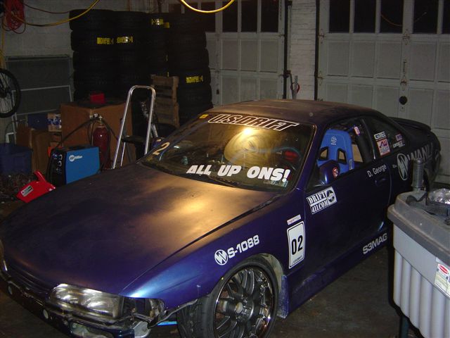

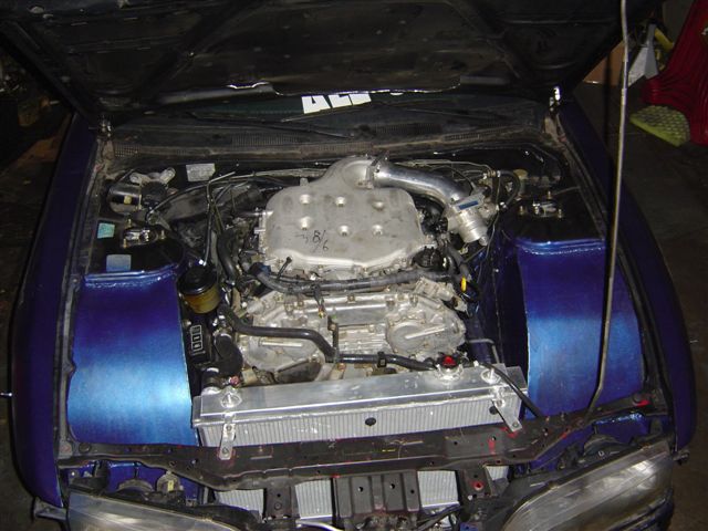

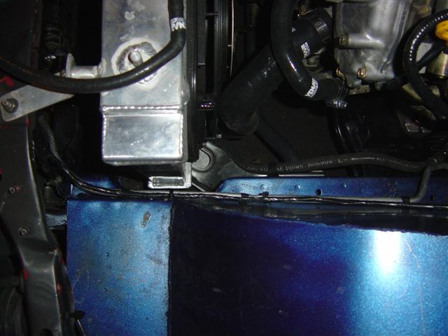

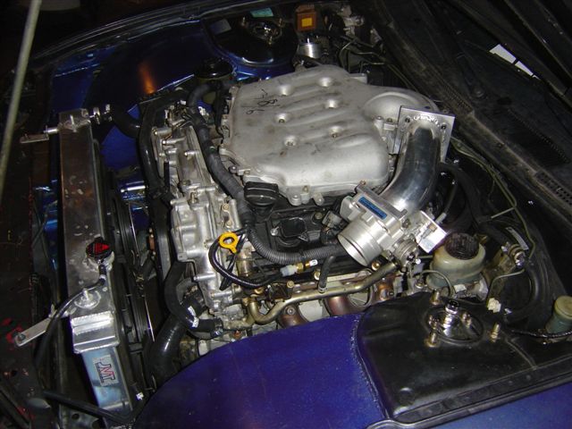

Well, the car is done and it runs freakin awesome. Striaght 3" out, not a hint of a muffler.
This engine is so nice, I wish Id done this sooner.
Attached Thumbnails Thanks Hal @ Injected Performance-dsc02898.jpg   Thanks Hal @ Injected Performance-dsc02903.jpg   Thanks Hal @ Injected Performance-dsc02906.jpg   Thanks Hal @ Injected Performance-dsc02911.jpg   Thanks Hal @ Injected Performance-dsc_2521.jpg
