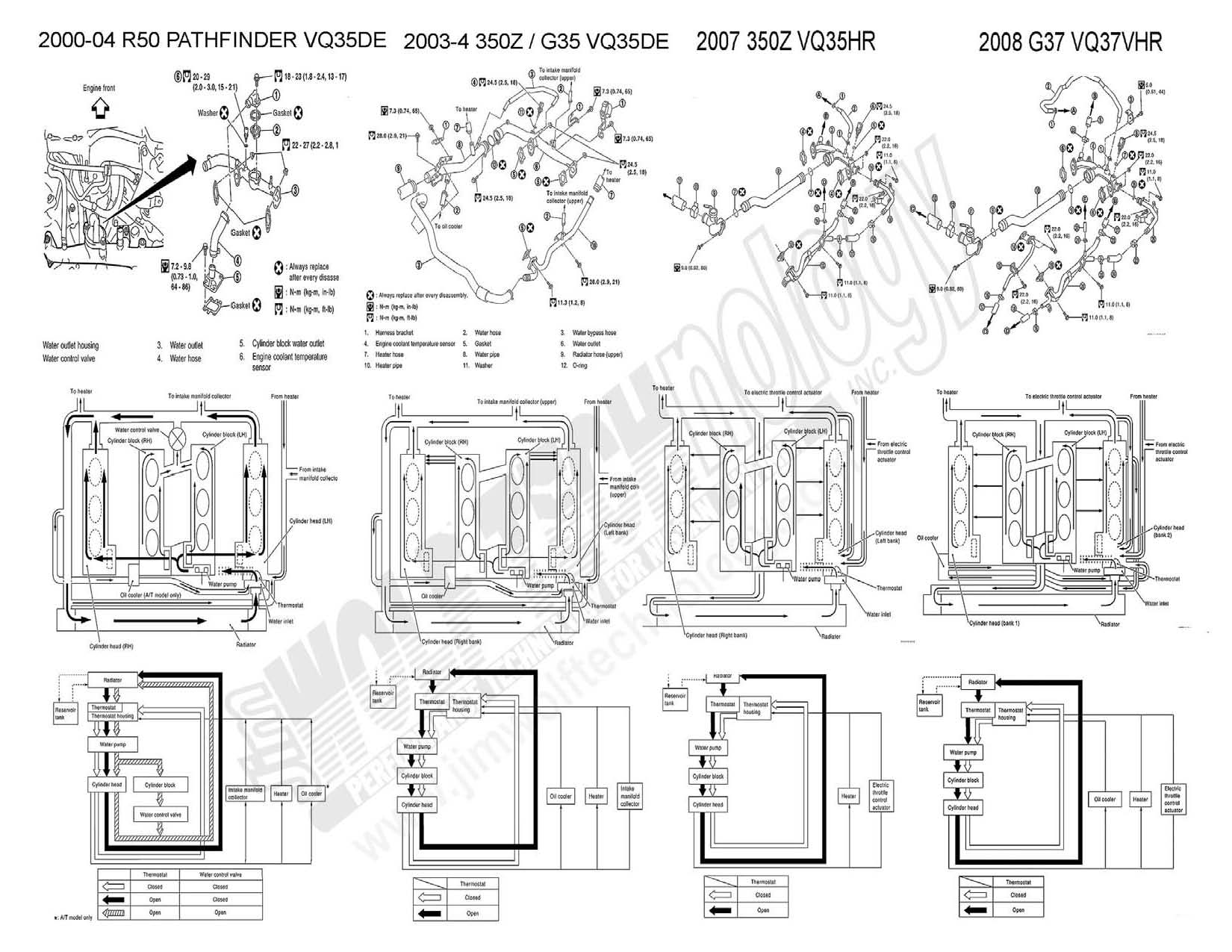

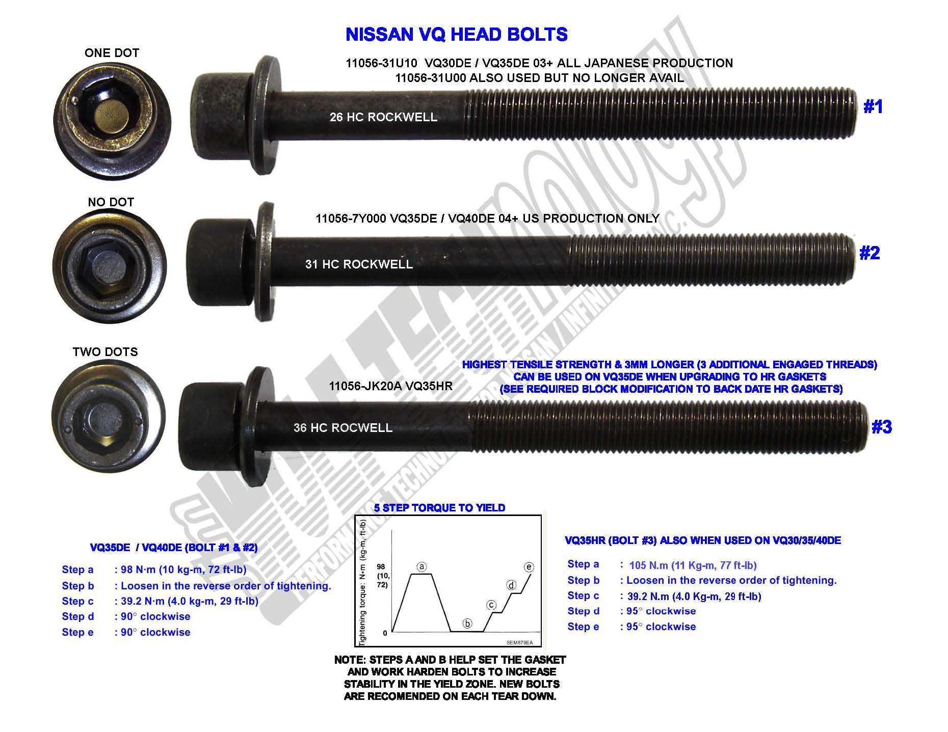

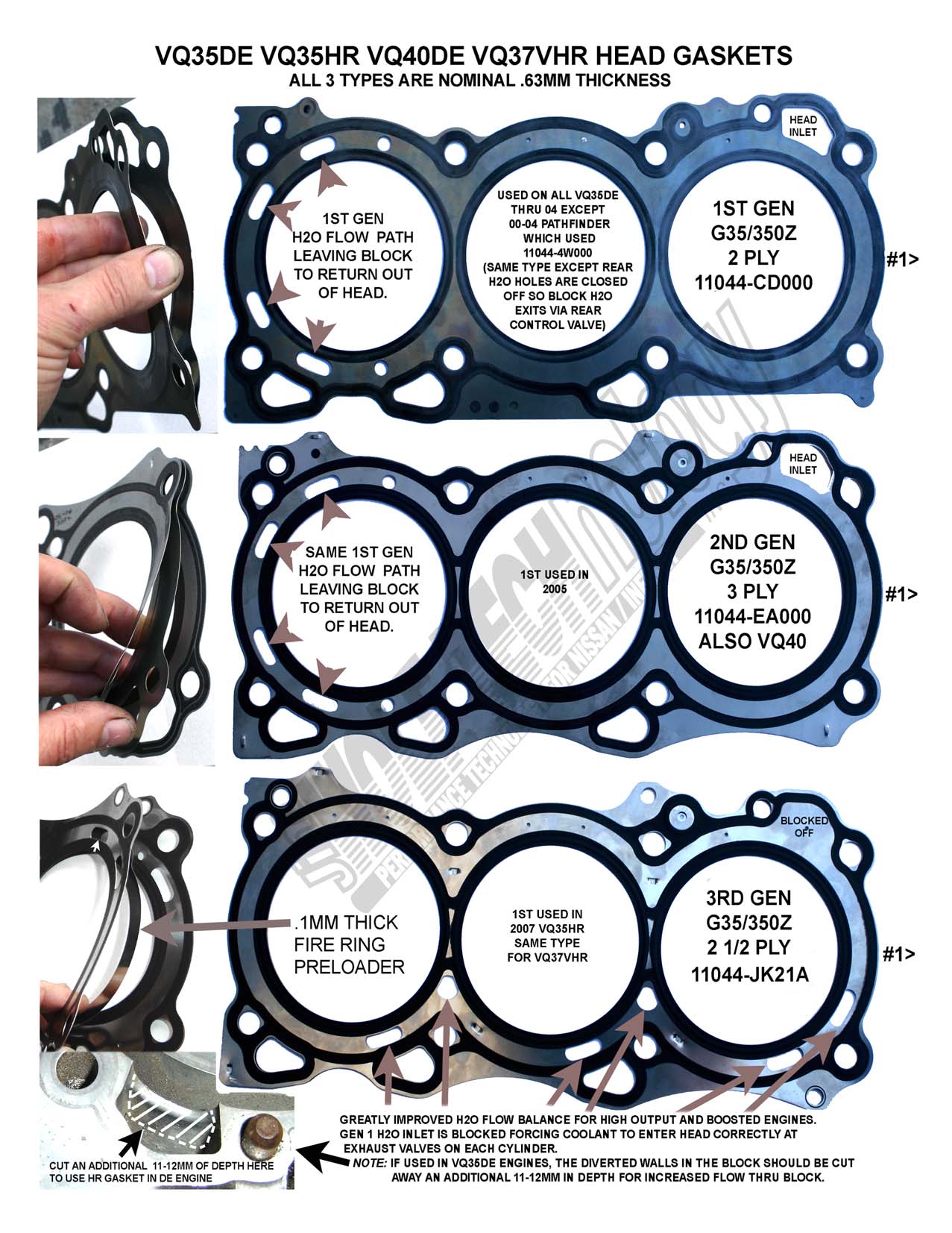

Since we are on the subject of Headgaskets and Head studs.
What are your experiences with the method that Jim Wolf employs?
(using OEM HR Head gaskets and HR head bolts on DE motors)
I have attached the files so you can see what I'm referring to.
What is the consensus on ARP Head Studs needing to be re-torqued after X-amount of miles?(just trying to dismiss what is myth and what is truth)
I would like hear from both shops and technical people and peoples personal experience with either setup
Attached Thumbnails HKS head gaskets...good ? / bad ?-vq35-vq37_coolant_systems_head_gaskets_head_bolts_page_1.jpg   HKS head gaskets...good ? / bad ?-vq35-vq37_coolant_systems_head_gaskets_head_bolts_page_2.jpg   HKS head gaskets...good ? / bad ?-vq35-vq37_coolant_systems_head_gaskets_head_bolts_page_3.jpg

There are some people testing the HR head studs and head gaskets for certain build applications. The limit is unknown as far as I know. They will be more budget oriented for those looking for the 500-550 whp mark. Over that is where the questions have been raised.
If the HKS Head Gasket is just using better material but still the same design as the DE head gaskets wouldn't it still be flawed as far as its design.
I look at the HR Head Gasket and see more even distribution of coolant through the heads due to added channels which would eventually lead to better cooling of the motor specially when pushing our motors.
Combination of possible HR Head gasket and ARP studs?
What you're saying is correct but many have not had issues with the HKS.
While its true no one is having issues then why are people doing the pathfinder cooling mod and bigger radiator if not cause of cooling issues. If a head gasket can contribute just like those mods to the cooling effect needed for the motor it should be seriously considered.
