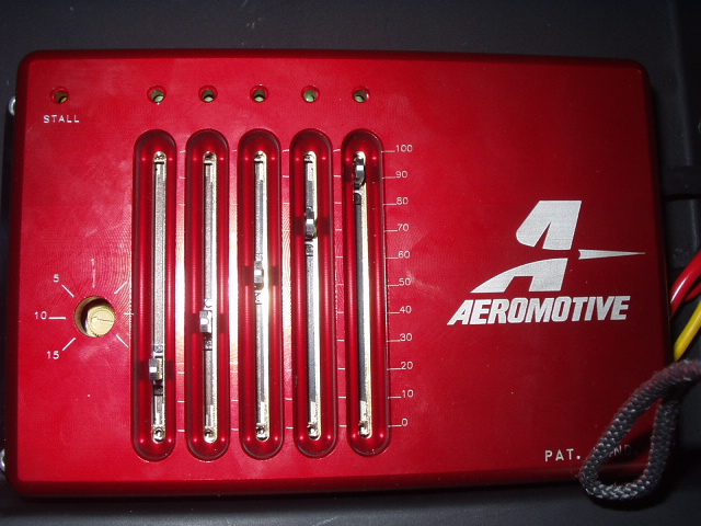

Anyone who has the Procharger, will you please let me know what your settings are on your EFMU....now I know every car will be different but I would like to get an idea of where I should be since I wont be able to dyno the car and use an o2 sensor until next week...a pic would be great, but anything would suffice...thanks!

This is a pretty rich setting.....but it's what i'm running on until i can get tuned on tuesday

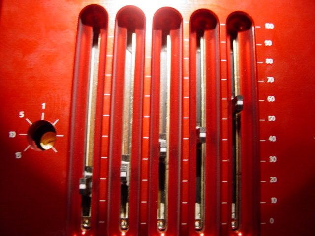

Here's mine. Dyno tuned at Altered Atmosphere.
Attached Thumbnails Somebody with the Procharger.......-fmu-settings-004.jpg

Does the screw dial magify the the slider settings? elektrik_juggernaut you have almost no room for adjustment on that last slider.

actually there's no need for any adjustment higher than that........it's WAY rich right now ........the little yellow pointer at the left sets the scale, and the sliders determine how much fuel is delivered at that boost level.......the yellow thing determines how much boost each slider is equal to, so 8/5 roughly equals 1.6 psi of boost per slider.
