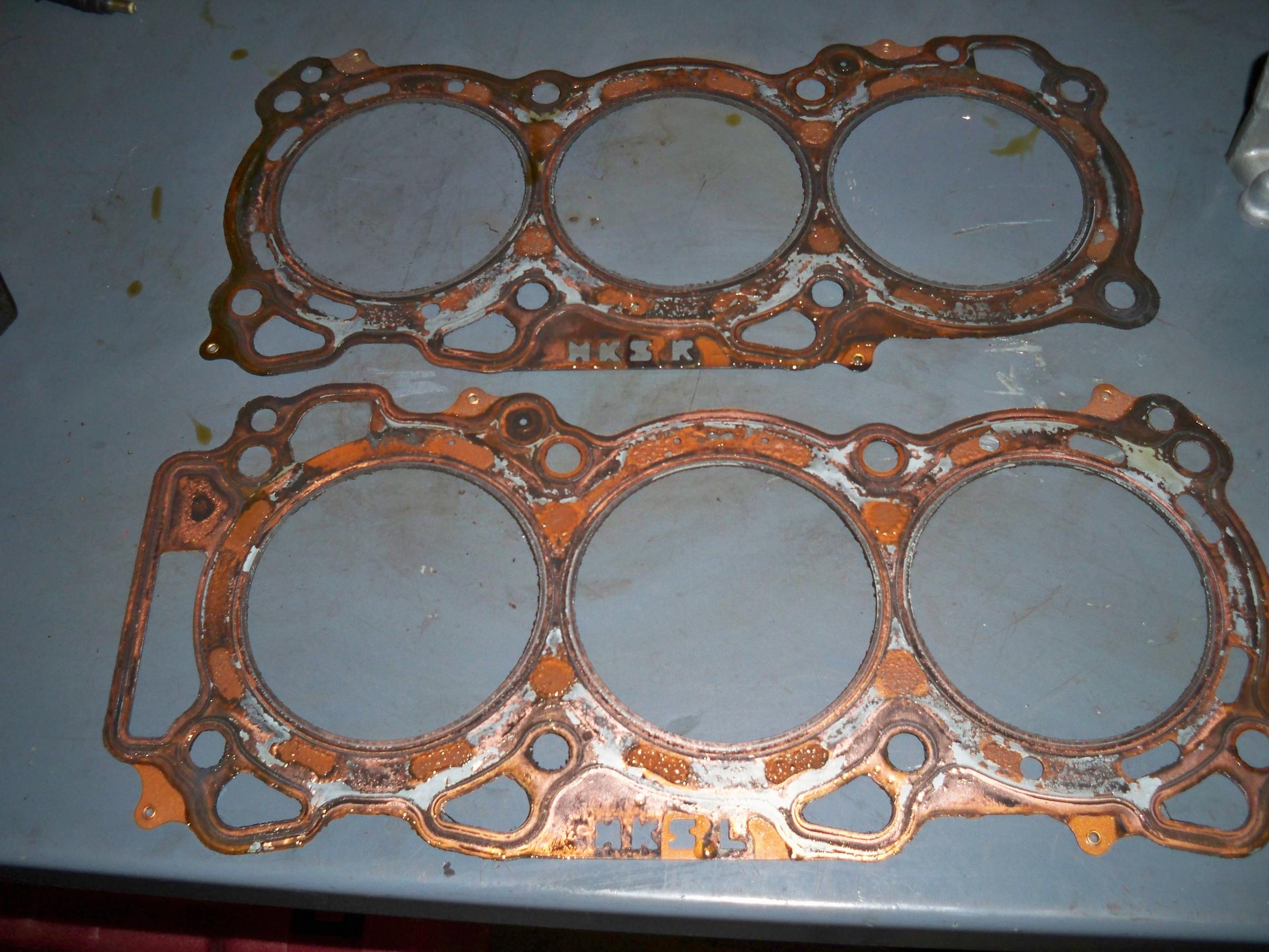

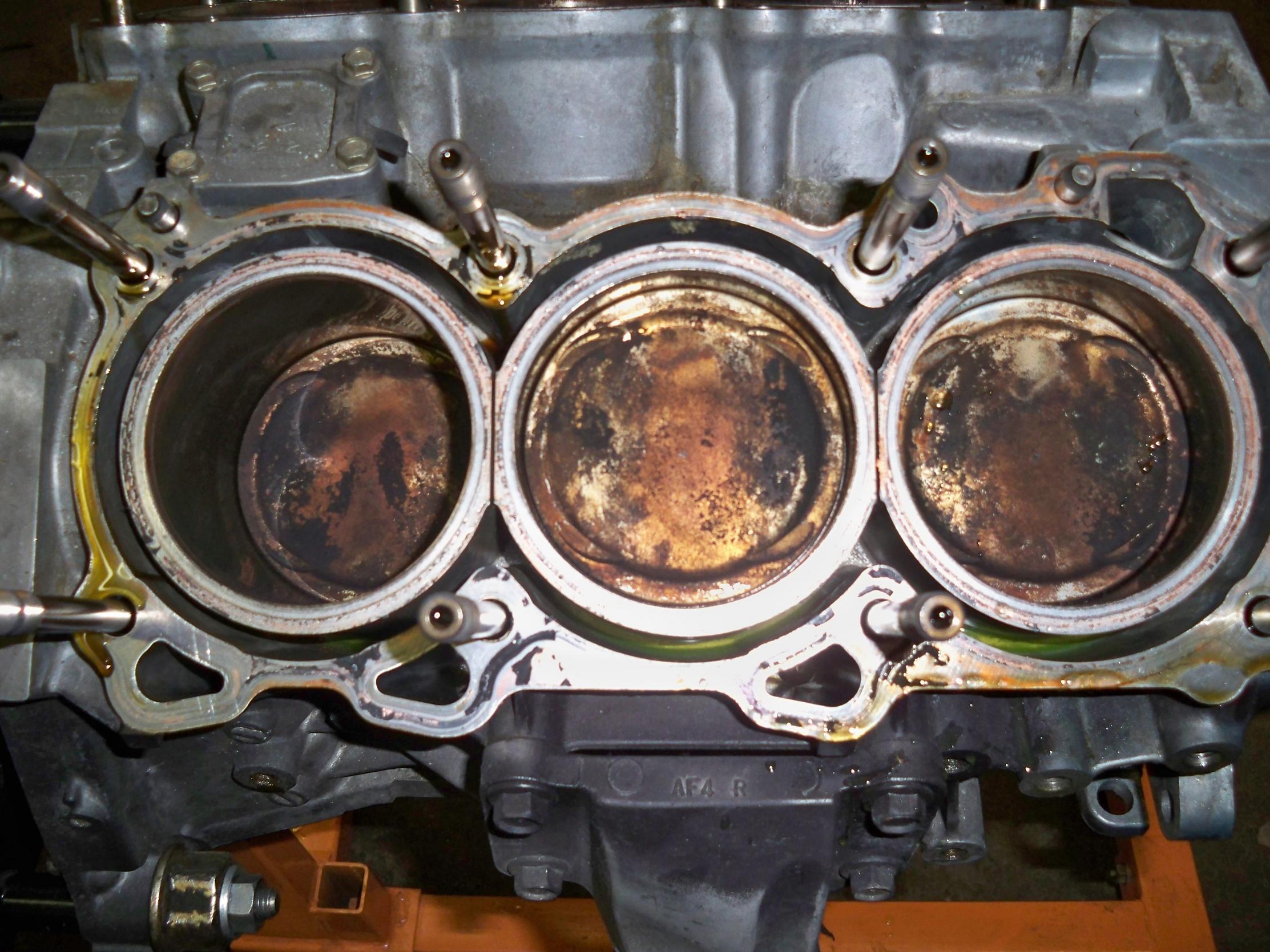

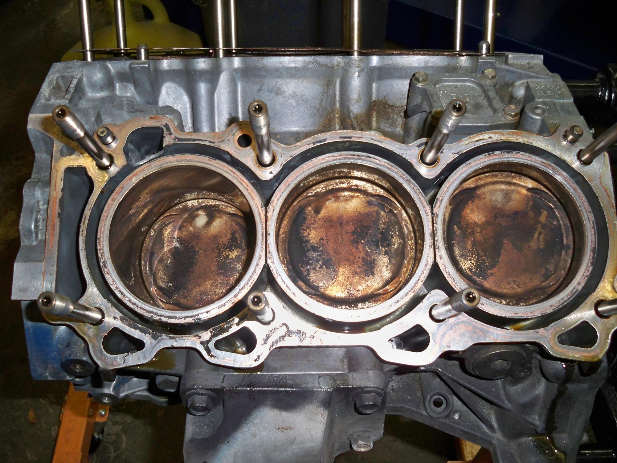

I think copper sealent may have been used on the motor Cas007 originally bought. I don't think his mechanic/tech liked it. But it looks like whoever applied it got it everywhere, even on the pistons (unless it was a copper colored ceramic coating on the pistons, which I doubt, because my pistons are ceramic coated and do not look like his did).
Originally Posted by Cass007
I ask Frank to pull the oil pan to verify the bottom end components and we also agree to pull a head to verify the aftermarket valvetrain and reset valve clearances. This is what we found :
Attachment 216846 Attachment 216847 Attachment 216848
Some moron had sprayed copper coating for the gaskets all over everything! Frank recommends a complete teardown at this point and I agree.
Lots more coming tomorrow - I'm tired.
That is also a spray and not the same thing as copper rtv. Copper RTV is in a tube like regular silicone and works well on exhausts. I used to deal with circle track race cars and we often had problems with the headers not sealing on ported heads and would coat the gaskets with copper rtv before installing. It's a little messy but adds an extra level of sealing.
