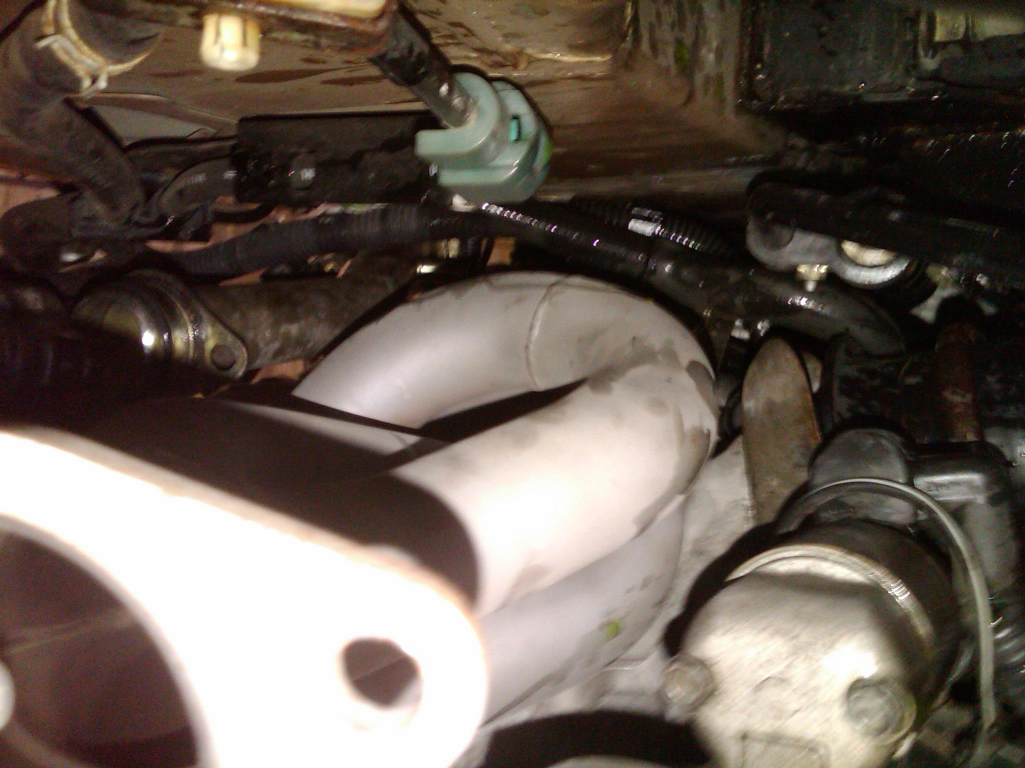

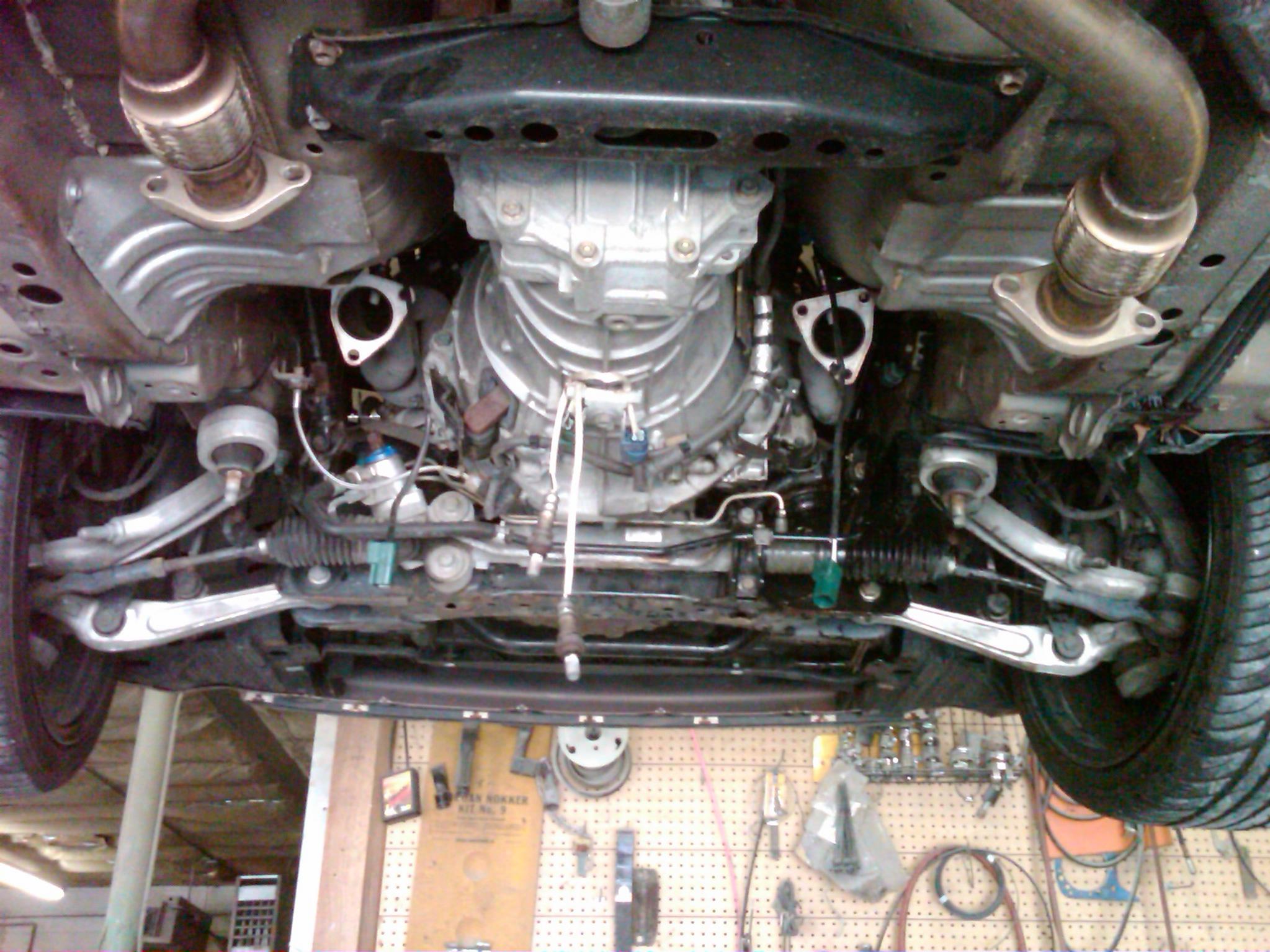

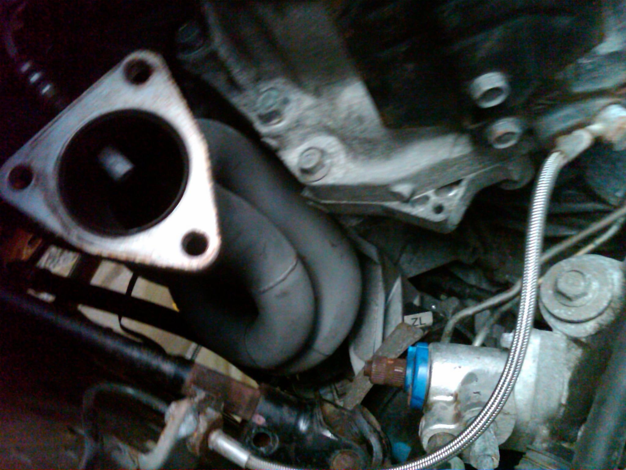

Default got the headers in and they were a *****
now ill be puting the super charger on over the next couple days. waiting for my RC injectors clips to get in

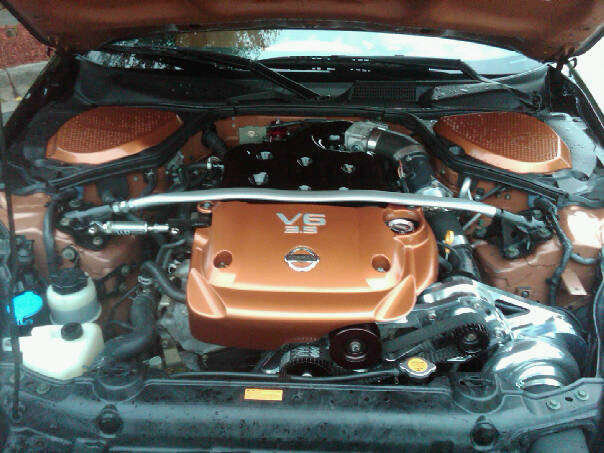

Default all done
ended up with 406whp. 440 rc, aam fule return, unichip, 9lb pully. spacer headers and hfc. not to bad IMO
