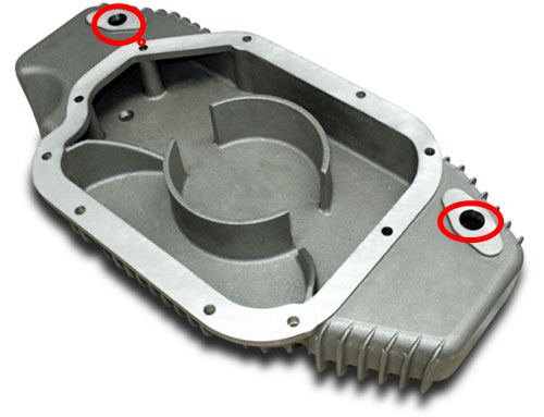

Good Afternoon Guys!
Anyone know what the thread size is on the APS Oil Pan for the return inlets? (I circled them in the pics)
I can't remember if they are 3/8 BSPP or BSPT. (also if anyone knows where to get one or has an extra, that would really help me out. I've searched everywhere but can't find it. Thanks!

i like how its got walls around the oil pickup to block oil from getting to it.. nice pan.

In case anyone ever needs this, the APS Oil pan uses a 3/8 BSPT fitting for the return lines.
Only place i found in the US that carries them is
http://www.mcmaster.com/
You have to order 5 of them at a time. So you'll have a few extra. Thanks!
