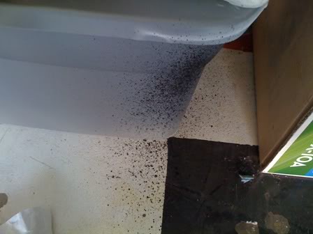

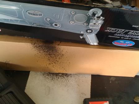

I’m thinking it might just be running really, really rich; and if anything I might just be having some blow-by too. Trying to get it into the tuner this week sometime.
This weekend I parked the car in reverse, the next day I opened the garage, fired up the car and the exhaust left this behind:

Did you read my post in regards to turbo?
