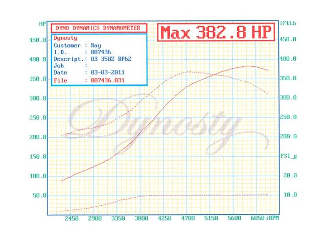

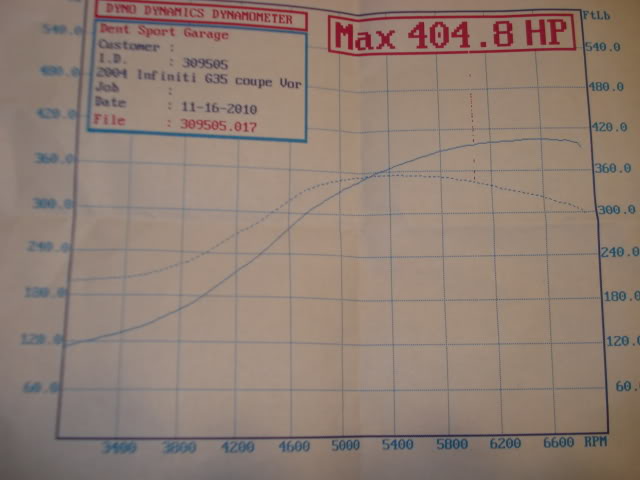

I have noticed the same thing with the BP kit (and every other ST kit for that matter) that once you hit about 6000rpm with OEM headers on the stock block, the power will start to fall off.
These are same BP kits, same turbos, same brand dynos.... can you guess which one has the OEM headers?
Here at about 5800RPM:
Here is another customer with a 6262 T4 .58 on a different dyno (stock block, 9psi), do you think he has headers?:
That is my constructive contribution to this thread, which is now way off topic... This is my experience with the OEM headers so far, some may disagree, and that is fine. I am not going to argue about it.
