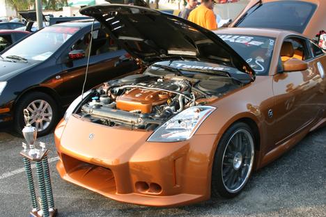

ok i just got the greddy tt kit and i purchased it for only 6200 with intercooler so i think that was pretty good but now that im installing it i need some help so i know i dont blow up my motor.
1) The kit doesnt come with the profec e-01 (i thought it did) It only comes with the emanage. Is the emanage preprogrammed for the timing i need or do i need to go in and reprogram it to retard the timing.
2) what else do i need to do with the computer of the car so i do not detonate
3)if i have a emange do i still need to send my ecu to technosquare so they can flash it?
4)how many psi can i run safely?
5)is the profect e-01 supposed to come with the kit?
6)anything else i can do to ensure that i dont blow my motor
7)i already have an safc-2 so i know that will help but can i plug a laptop into the emanange?
thank everyone for your help with this and hopefully i will be boosted with pics and vids and a dyno before the end of the week.
