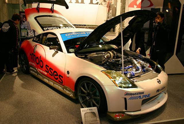

Default pic of the hood
pic of the hood
Old Mar 20, 2004 | 09:54 AM
tiswicked's Avatar
tiswicked
Posts: 113
From: East Orlando/ UCF area
Hell even the stillen supercharger needs an aftermarket hood with a hood scoop. I pretty sure if you have a hood scoop on you SINGLE TURBO MONSTER of a 350Z no one will even think it is any where close to ugly.

How are they keeping the hood closed? I didn't see any pins, and of course the front latch is gone.
Interesting, but kinda ugly to me. Well, ugly may be the wrong term....complicated.

I don't think that the JUN car was using anything but a VQ35, not sure where the info came from that it was a VQ30, but the front cover, heads, and cam covers are all unique to the VQ35 and are not interchangeable to be used on the VQ30 block. The pictures are pretty clear showing the 35 parts. With the single turbo, if you want to run big power numbers, then a single is typically the way to go. Each exhaust bank puts out enough energy to spin a smaller turbo, but to run high boost, the efficiency of the turbo is maxed beyond ideal and is whipping the air - creating more heat. A small T25 at 14 lbs can be spinning at 300,000 rpm, and way outside its peak efficiency. A T3/T4 hybrid can produce the same boost at 75,000 rpm. This means less heat and better effficiency, but turbo responds better using the energy of both banks rather than just one. This is the same reason behind single turbo conversions on Supras and GT-R's. Two well matched turbos can produce even better results, but would be much more expensive. The new disco potato turbos JWT is selling for the Z32 is a prime example. Excellent efficiency and design allows the higher boost and power numbers of a large single turbo like the T6 line (700hp), but with better response. Of, course, these turbos run well over a grand apiece.
