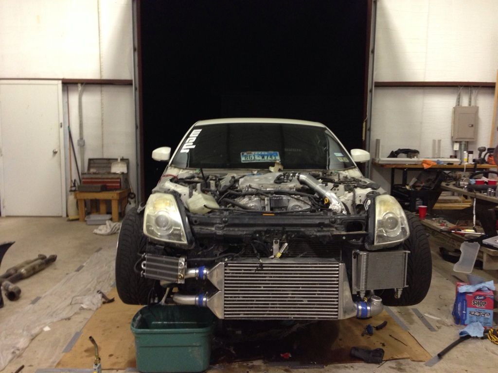

Starting to look like a car again, installed oil catch can, moved power steering cooler and made a bracket for it/ oil cooler.
Guess who forgot to drill and tap for their EGT gauge when the motor was out of the car..... **** me

Op--aweswome pic !! That's a huge *** oil cooler. How much oil does she have now-6ish quarts??

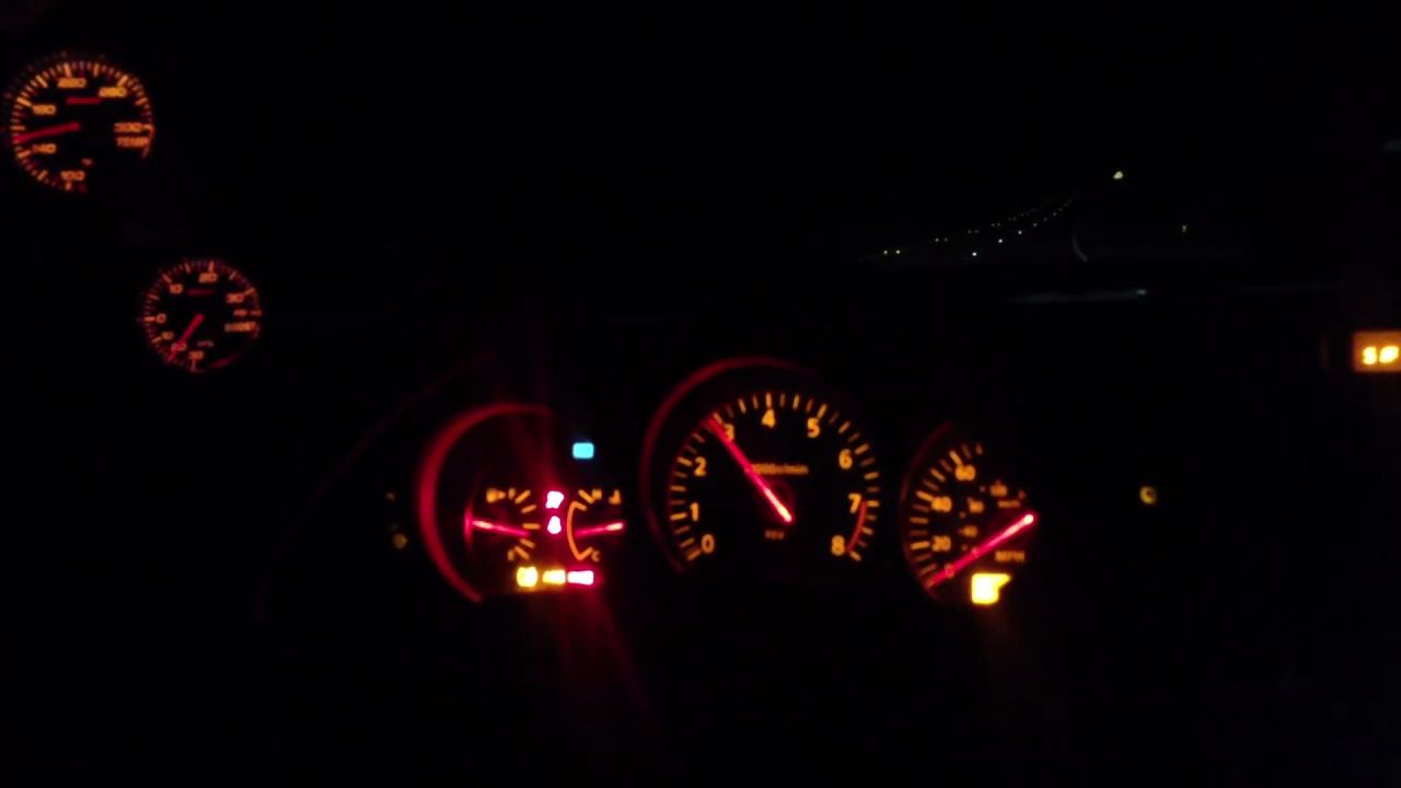

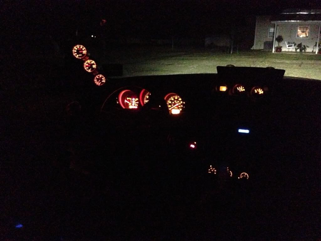

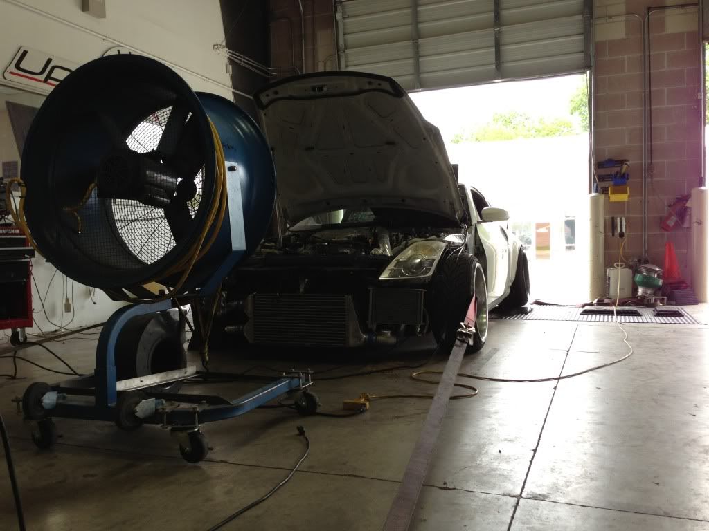

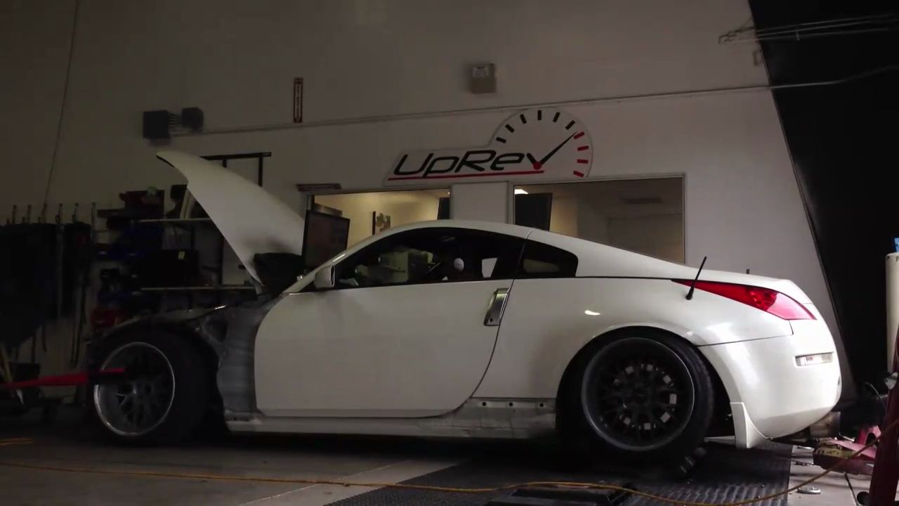

Question.... My aem uego is reading 10.0 flat under WOT (doesnt read lower ) Even since the day of my tune. Think its a bad sensor? ( purchased brand new ). Could a bad O2 sensor cause the car to run rich? I am going to take the car back over to Uprev next week or so to get everything checked, just curious on your opinions!
The video on the dyno was when the car was only at 273 hp, i wasnt able to get a video of the full effect .
VIDEOOOOO
VIDEOOOO
ANNDDD VIDDEOOOO
Good sound of the Tial
Shot of the gauges
Dyno sheet
398hp/335tq
I also picked up a new daily! My miata was toast after the hail storm we had here.
Old May 24, 2013 | 01:05 PM
  #54
bmyles's Avatar
bmyles
Joined: Jun 2012
Posts: 477
From: San Antonio, TX
Because you are running Uprev, the AEM UEGO has no effect on your tune. You are still utilizing your factory O2 senors and MAF for fuel control (technically only the MAF at WOT). I would definitely get it checked out to make sure you aren't actually running that rich, though.
