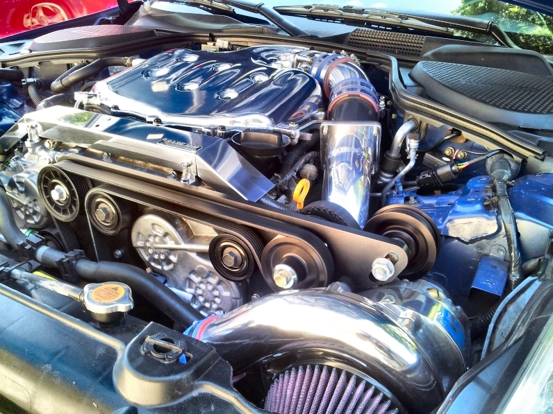

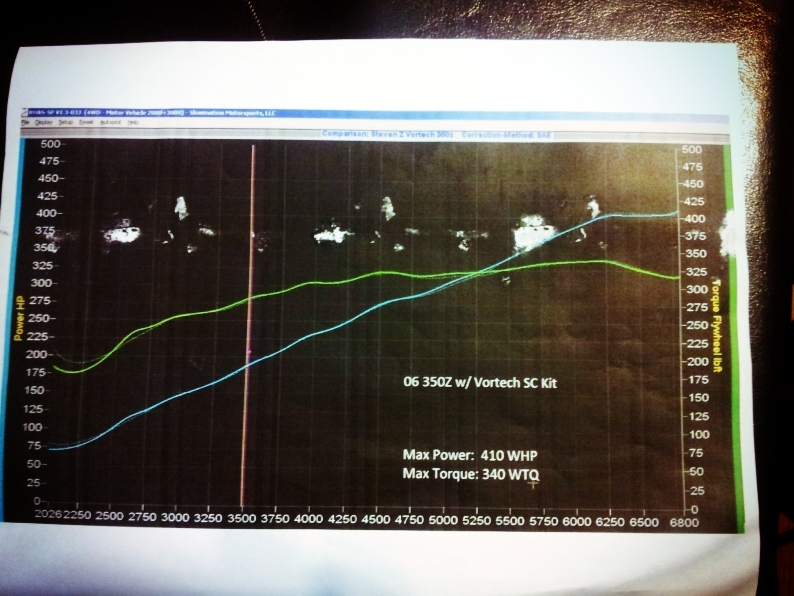

Update 8/30/13
Here is a crappy pic of the dyno.
Engine bay all cleaned up..

Old Aug 30, 2013 | 06:44 AM
beven6's Avatar
beven6
Posts: 16
From: Michigan
So I've had the car back for a few weeks now and thought would give a quick update. The car ended up making 410WHP and 340WTQ at 6psi with the 3.12 pulley. I am running out of fuel which is the reason for only running at 6psi. The shop had narrowed it down to something wrong in the fuel assembly, I will be buying a new one and installing it sometime this winter.
