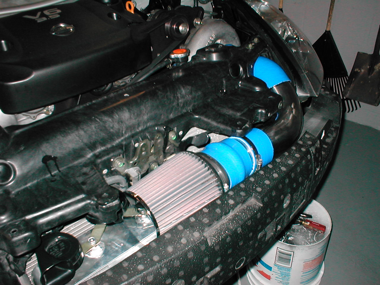

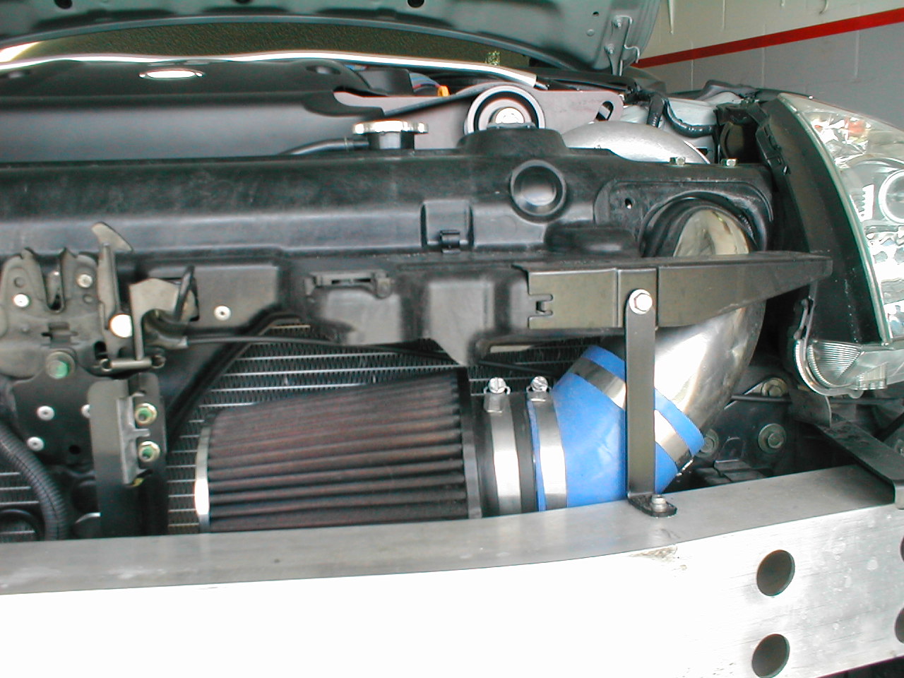

I did mine out the front, for the very same reason.
pic 1 is with stock Vortech Intercooler.
pic 2 is with Large Intercooler.
