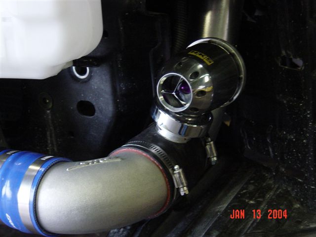

Old Feb 10, 2004 | 03:14 PM
ACP's Avatar
ACP
Posts: 405
From: Naples, FL
Originally posted by g356gear
It's not a stupid question at all.With the Greddy kit the BOV will go down in the driver front corner before the MAF on my car. There are a few of us who are adding the BOV because it does not come with one in the kit from Greddy. I think it is a must for any kit.....apparently Greddy thinks they do not need it. Possibly for emissions reasons.
like deviousZ did ?
Old Feb 10, 2004 | 03:25 PM
Jeff@Evolution's Avatar
Jeff@Evolution
Posts: 1,119
From: Chantilly, VA
Originally posted by ACP
like deviousZ did ?
Did he experience any problems?
