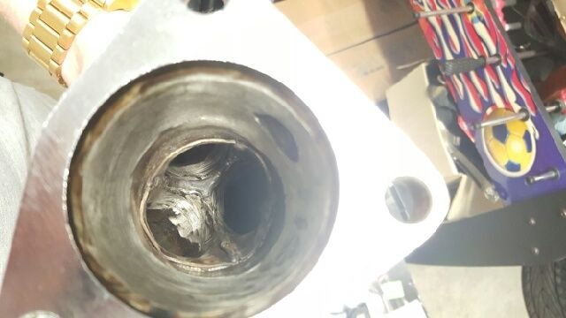

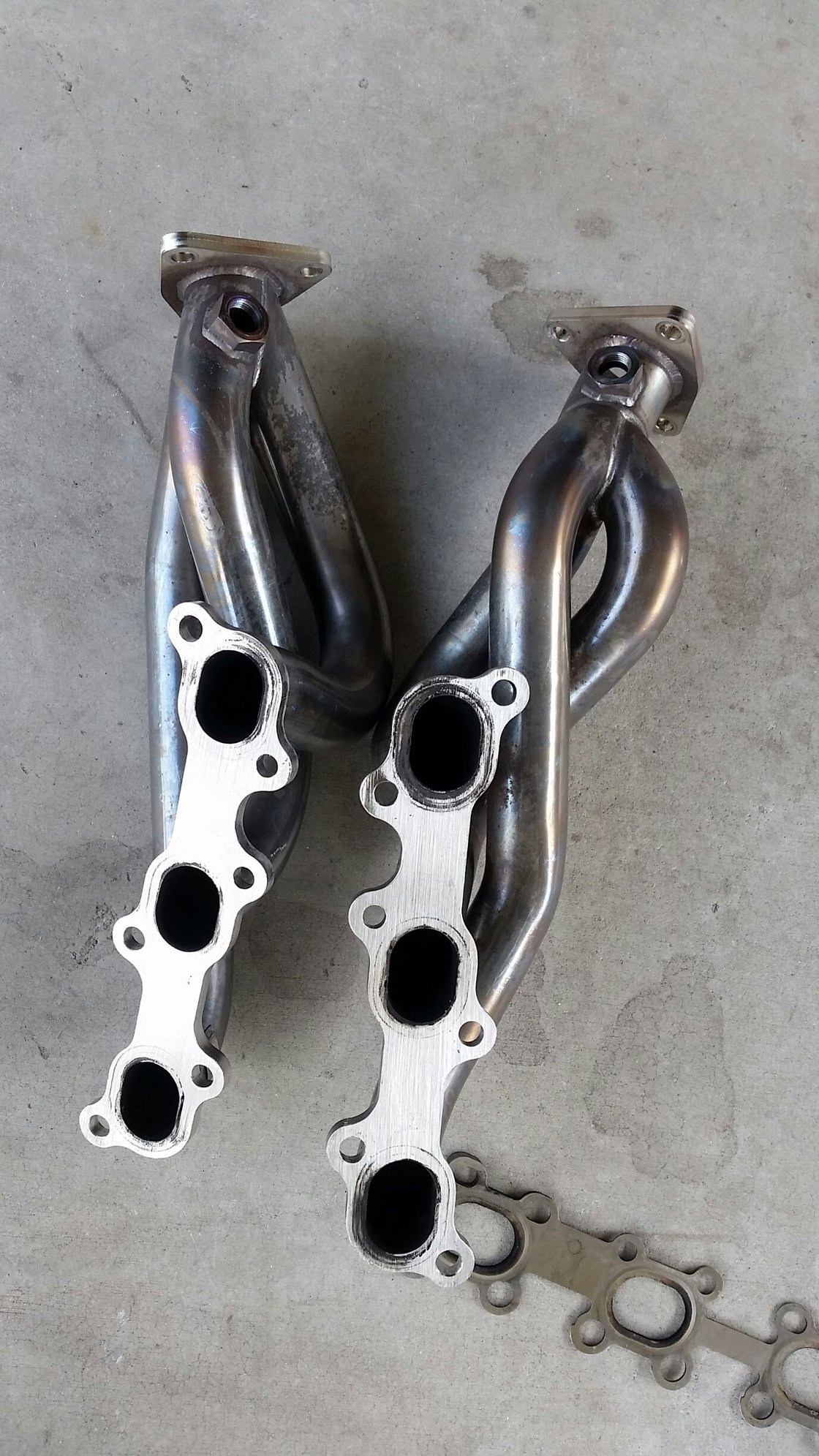

I brought Fujitsubo headers thinking they are 2.2" ID but they are only 2" ID.
https://www.fujitsubo.co.jp/prods/de...03313/00000748
Am i better off finding another set (RHD) that is 2.2" like the Megan Racing ones (quality not as good as fujitsubo but they are 2.2" ? or has people used 2" ID and got 600-700HP ?

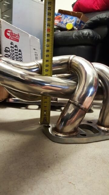

p.s fujitsubo drivers side RHD is 6" from bottom of runner mount to top of widest pipe closest to drive shaft. The other side is 7".
Megan is 6.1" for the drive shaft side and 5.9" for passenger side. So they will fit but will they not crack ?

Fujitsubo

The 2"ID Fujitsubo pictures above you think will be fine? Its not worth getting megan 2.2" ones or asking a fabricator to cut the collector ends off and make 2.2"

megan height that goes on the RHD side

Fujitsubo inner collector

Headers are fine.
