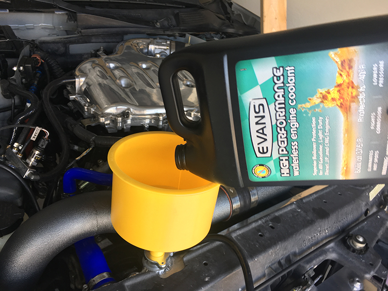

Are you using a Lisle type spill-free funnel for your radiator/coolant?
Old Jan 23, 2017 | 11:03 AM
35reilly's Avatar
35reilly
Joined: Aug 2015
Posts: 385
From: south jersey
Did all that. Just boiled over. More of a mess then good.
