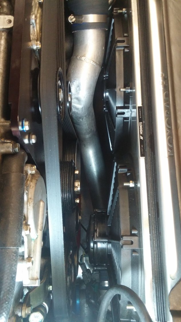

this is what my measurements got me to install..as far as fitament
I had to trim the mishimoto shroud around the upper pipe ,remove the down pipe to the blower and remove the air filter, to be able to get the shroud in and out without disconnecting the upperhose of the radiator
then I installed the fans with the shroud already in place between the rad and engine
also I was able to pull the shroud out then install with the pass fan on but not the driverside fan
note this is the koyo 36mm radiator..not the 52..honestly I cant see fitting these fans with the 52mm koyo

[QUOTE=vegasanthony;10883541
this is what my measurements got me to install[/QUOTE]
you have no room for the air to flow through and out of your engine bay!
you have to give the air a path to go, right?
