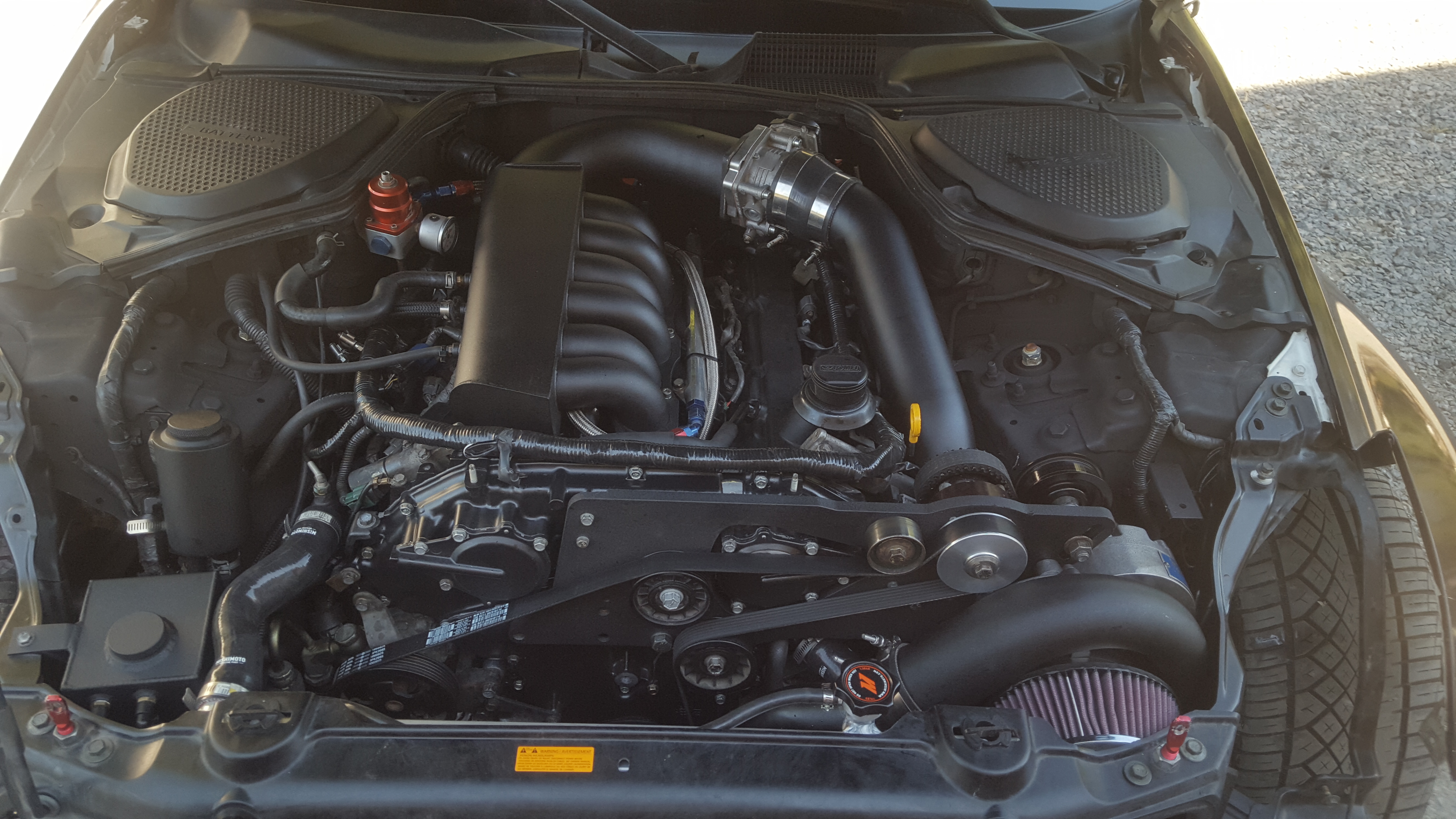

3. The idler delete is very simple and you only need to make sure your pulleys on your bracket are setup correct. I will supply a picture of my bracket and belt orientation to show you how you will want to set it up. If your supercharger bracket has pulleys in different places then you will want to arrange them to match mine. You will want to double check what length your serpentine belt is, so take a look at your belt and let me know what the part number on it is.
