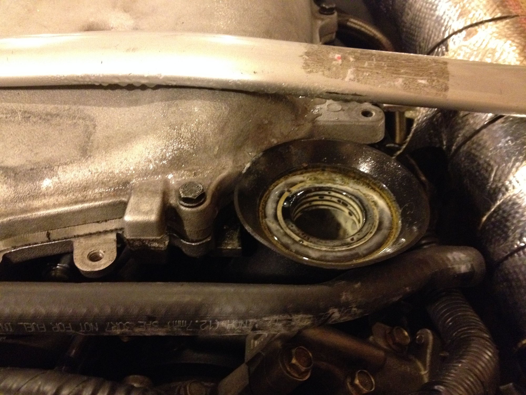

post pics of your oil cap ... here's what mine looked like:

Jeez bealljk, mine looks similar but there isn't as much foamy oil. Same color though, just less.
As some other members said though, this is not a definite indication of a blown head gasket since the moisture could be from condensation inside the crankcase from previous cooldown. I believe you actually may be getting at that point?

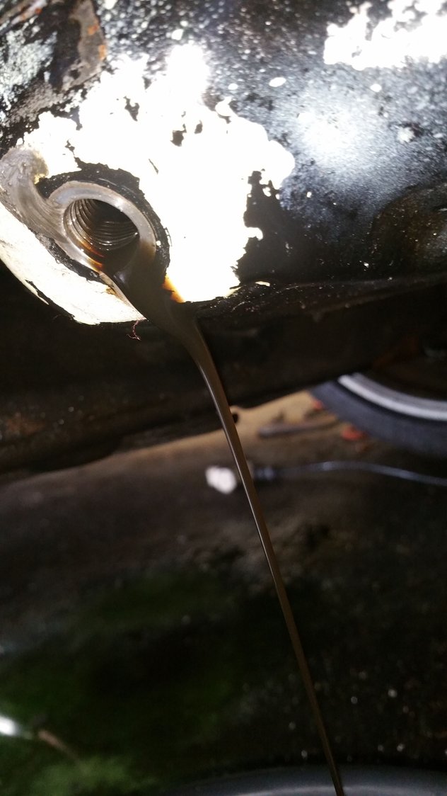

Looks pretty normal I guess. All of the bubbles settled out of the oil after it sat in the drain pan for a few minutes. It doesn't look too bad, no layers of water or glycol that I can see
