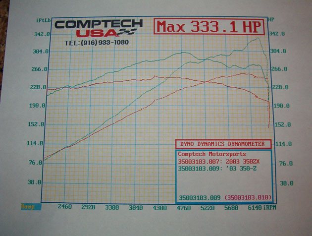

here is my dyno...............

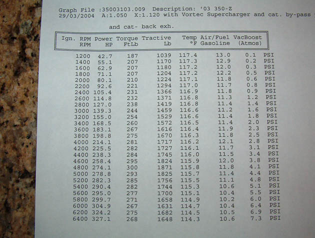

A/F was rich as **** and I have problems..................

What Problems are you Having.
First Dyno looks like it should.

I agree it looks good unless it is not running right but the AF is fine, maybe a hair rich but not bad at all.

PROBLEM SOLVED, THANK YOU GUYS, the intake blew off the plenum and I never looked under the hood because I was thinking the worse, NEED TO PRAY MORE...........will fix in the morning, thxs guys.............anyways about the dyno........the blue line is a baseline dyno with the Vortech supercharger (no tuning has been done) straight out of the box and the red line in the dyno is my car stock with pulleys, Borla cat back dual exhaust and CAI intake. I am happy with 333rwhp, it hauls azz at 4,000+rpm..........NO DETONATION to be heard at all.

What is up with only 7.3 PSI? Did they leave the underdrive pulley on?

No he took off the pulley.
Nice numbers, fluidz, but don't settle for that. With tuning, this kit is capable of much more as I will demonstrate in ... oh... about 3 more days! I mean... uh... no... nothing going on here in Charlotte.... hehehehehe

Yeah, there is easily another 50+ hp in there with tuning.

nice results definitely tune it to a consisten 12.0 across the board and youll pick up some power!

Fluidz...congrats on the installation. Those are pretty nice results for out-of-the-box tuning. As mentioned with proper tuning, i thing you can pick up about 50hp without even changing boost levels. Have fun with it!

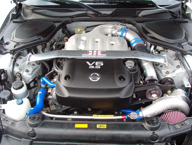

engine bay picture

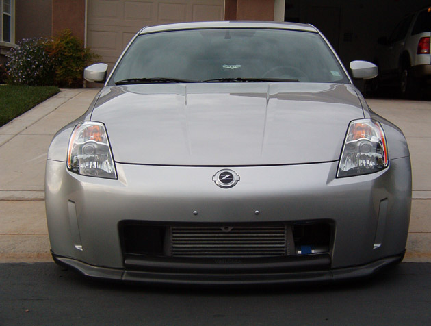

intercooler

Very nice looking numbers and outstanding looking kit. It is because of you that I will be getting one.
