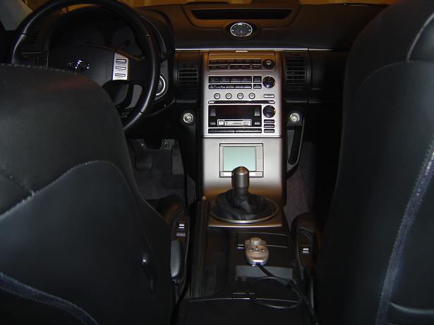

I soon am going to join the FI brotherhood (Greddy TT from Jason @ Performance Nissan) so I started on my install. I wanted to flush mount the E-01 and datalog the A/F and boost. Especially since I have a G35 and no one makes a A-pillar gauge pod. First I cut the hole, then plastic welded the hazard light button & the rest of the hole that was there originally. Then I used duramix to bodywork the plastic. Primed it, sanded it, then painted it. It was very difficult to match the interior color but I think it turned out pretty good. I couldn't remember if a lot of you have done this, but I don't remember seeing many of your interiors.

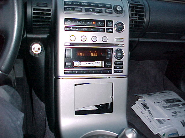

pic 2

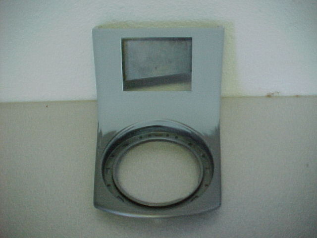

pic 3

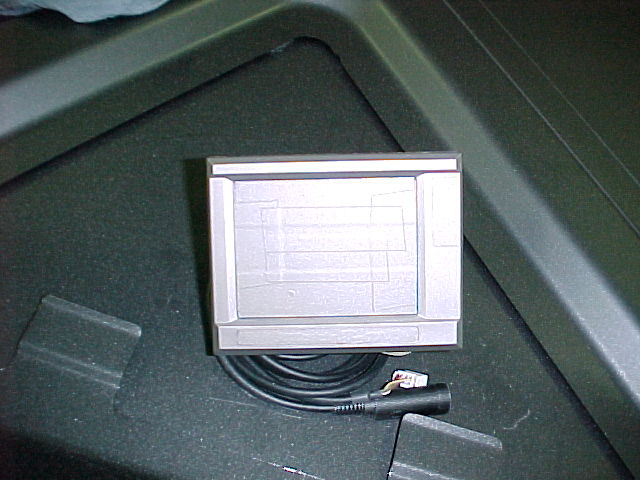

pic 4

Looks good.....I see you rejected my advice about not painting the black plastic panel on the right side of the Profec which contains a warning light and photosensor element. Ha! I know..i am a total smart-***!
Seriously...it looks really nice and OEM...you are quite a craftsman.
only question...where the heck is the remote going to go.....did you paint over that too????

I didn't paint over it, I just haven't removed the tape yet!

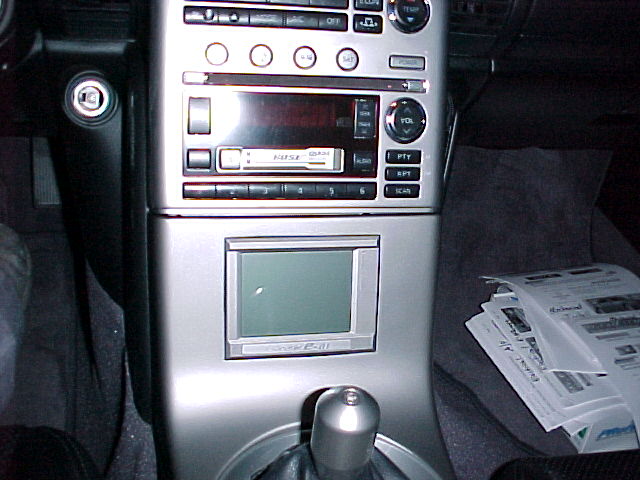

I don't think the Z has that much room there. The A/C controls are sitting there. Looks good on the G35

pic 5 w/remote location. There is a blank button between the heated seats button that I will drill a hole into and run the remote wire through.
