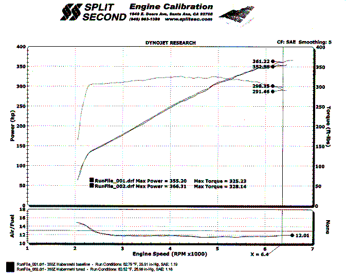

Default Dyno Chart w/AF
Here we go

nice tq curve/line!

TQ Curve

Very nice TQ and A/F curve.. impressive. I thought Stillen Stage 3 only put out 332rwhp and you're running Stage 2 and already surpass the initial dyno for the Stage 3 setup.

that was my initial reaction too... WOW thats an awesome torque curve!!!

The beautiful thing about that TQ curve is that there's really no curve.

I was standing to the side of the vehicle during the first pull and thought I would be lucky if I had 310-330 rwhp.
I about s*it myself when I saw the first run numbers and the electric motor HP and TQ curve.

quick question::
why are the CF's so high?? you're in jersey, right??
a 1.19 CF equates to 303 rwhp and 275.63 lb-ft tq raw output...........
what's the elev (above MSL) there??
down here (we are low, admittedly) my raw numbers had a negative (or less than 1.00) VF applied...
i dont understand how the temp and hum. equivilate to a positive 19% bump...
