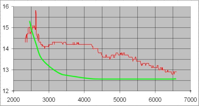

Well, Pin#62 did the trick! Thanks guys!
Here's an Excel graph of what my current A/F looks like at WOT based on the data logged by the Zeitronix (3rd gear run).
The green line is what I am shooting for when I tune the eManage unit.

^ Is that under boost?
