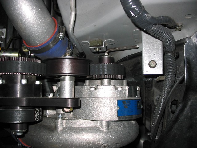

the allen head bolt on the backside of your supercharger cog pulley, mine was VERY loose to where the washer would spin and the cog pulley would shift about 1-2 mm, id hate to know what would happen if this would have slipped off. i tighted it at first just with my fingers because its hard to get anything in there to tighten it, but it was just as loose the next time i drove it, but i finally cut off an allen head wrench to where it would just fit in there. now ive torqued down on it pretty good. this probably wont happen to anybody else but just figured id let you guys know just to check it out.

thats the same thing that happend to mine. if it wiggles around, your teeth probably snapped off.

eww, i remember when that happened dollar, i think i caught mine before that happened.

Yes it happened to mine what size of allen key did you use?
I put some lock tight on mine it is holding good now.

i think its a 5mm, not sure, no i never pulled it off, i didnt have any serious offers so i guess im gonna keep it.
