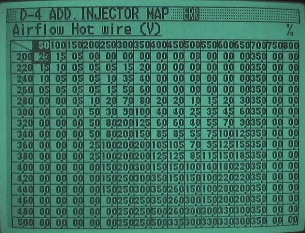

ETX's screen shot of Greddy's basic map for the TT doesn't display anymore . . . does anyone have one that they can display or PM? I take delivery of my car today and it would be nice to be able to tune the beast

a screen shoot

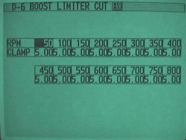

boost limiter
