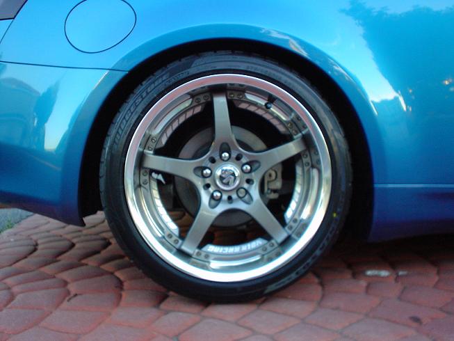

i have volk sf challenges...10.5 in the rear...im also dropped on eibachs (1in all around)
the offset is +23. i dont need to roll and i have no rubbing issues

that looks like a 275/30/19 tire?

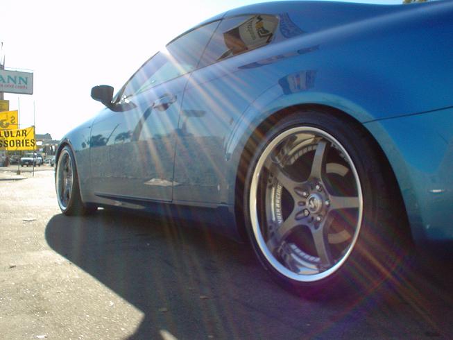

nope..those are 275/35..bridgestone so3's
jason, i called you about sf challenges in gunmetal. you never got back to me so i got them from vision autosport
