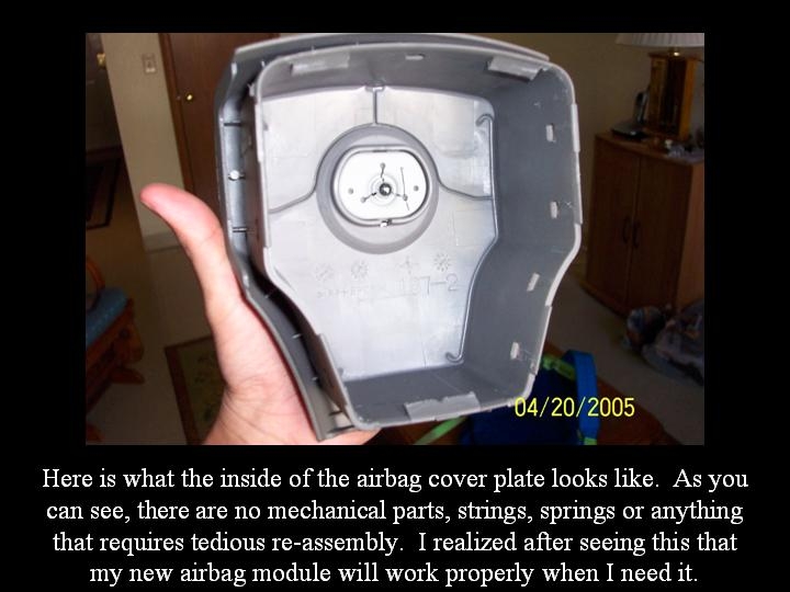

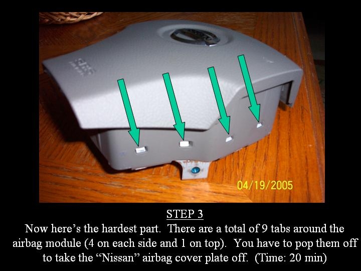

I just bought the tan one..
buuuuuuuut...
We have dual stage airbags, the JDM ones are single stage... so they still work, but your airbag light is on.
(Unless there is a way to swap the covers)?

Yes, there's a way. I just PM you, I have the DIY from g35driver.com a long time a go.
Attached Thumbnails Nissan Skyline Airbag Cover-nissan-skyline-350gt-steering-wheel-diy-step-3.jpg   Nissan Skyline Airbag Cover-nissan-skyline-350gt-steering-wheel-diy-step-6.jpg
