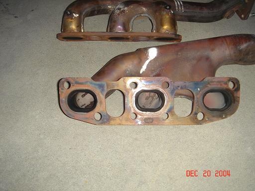

Heres a look at stockies for you newbs out there.

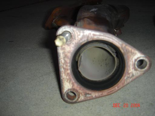

a look at the stock collector

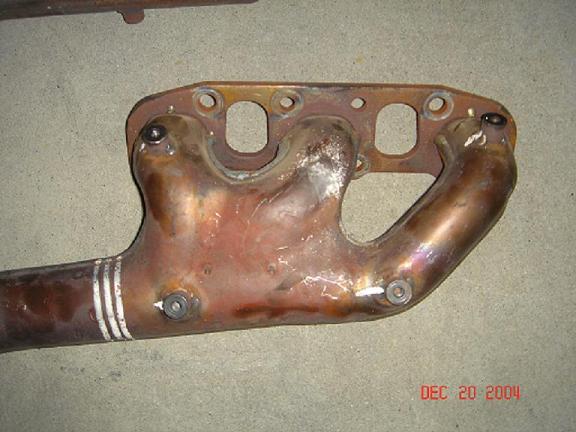

and the whole header

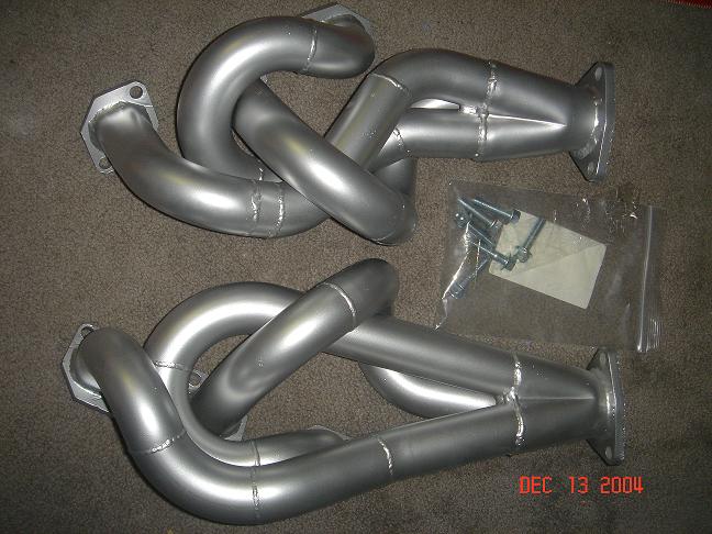

CRAWFORDS

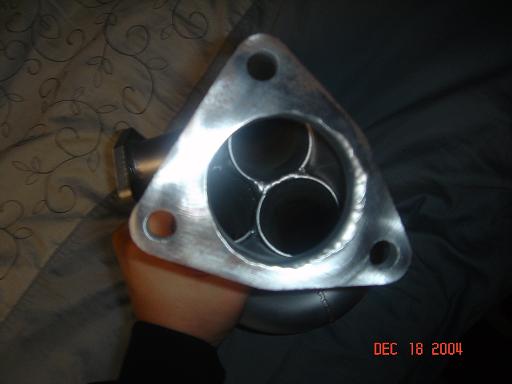

Crawford Collector, I think the merging of the runners could had been a little better. as well as the welds on the header could have been a little better. If I'm not mistaken I believe each header is made by hand.
Cant complain about the power though.

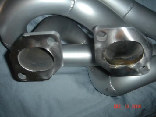

Runners

We thought about adding a merge collector...
Two things complicated it.
- Room to both our LONG tubes, and keeping the cats in the stock position.
- Cost vs. Performance
Merge collectors are not an inexpensive animal, as they in themselves are a work of art! Very few people in the country can make a genuinely nice piece that we would be interested in using.

Thanks for the explanation.
