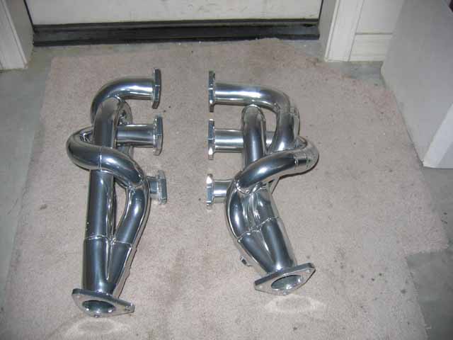

Originally Posted by lowrider
Mild Steel headers will work fine in New Jersey, IF they are first coated with Jet Hot. Got my Crawfords coated, and Jet Hot did a great job.
BTW, from everything I've read on the subject, the Borla is the worst power producing header you can buy, not much better than the stock manifold. I would stay away from Borla. For a low priced header go with DC or Strup, for the Best, Crawford. But you pay dearly for the best.
Pict. of my Crawfords with Jet Hot standard coating before install.
Lou

WRONG - There is a difference. Look at the construction. The Crawfords have 22" equal length tubes feeding a true collector. The inexpensive ones have unequal length shorter tubes feeding a larger merge tube that is not a true collector. Strup is a good inexpensive header, but it's not in the same league as Crawford.
