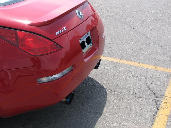

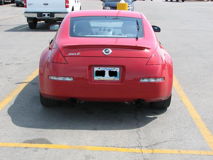

Installed my Injen SES Ti Friday evening. Wow what a pain in the butt. If I had to do it again, I'd pay somebody. I don't think I'm a mechanical genius, but I am familiar with a car, and it still took me 5 hours on my own. I think having a buddy help would have saved time.

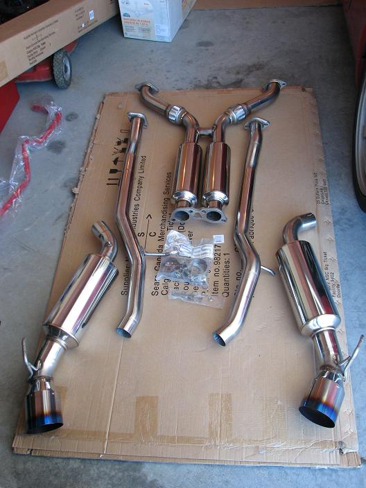

Injen01.jpg - The quality of the exhaust looks good. There was a minor scratch on one tip, but not too bad. The packing was MUCH more secure than the Borla TD that I sent back. There weren't any instructions which isn't mandatory, but would have been nice. I would have liked to have seen Injen include a bracket to attach the passenger-side mid-pipe hanger to the car.

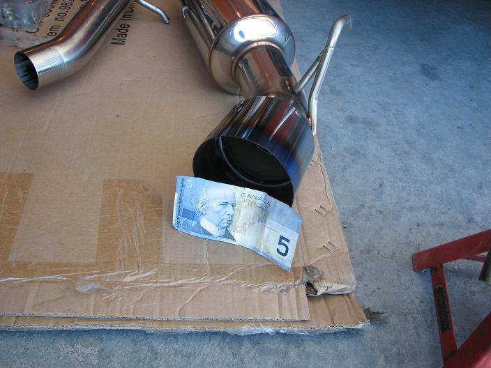

Injen02.jpg - Those are some BIG tips!

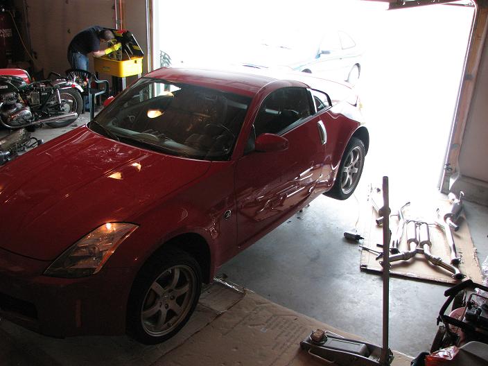

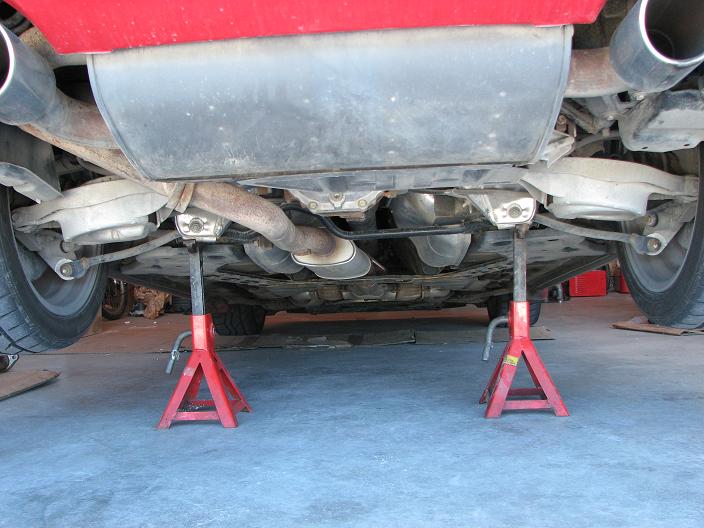

Injen03.jpg - I jacked up the rear of the car to install the exhaust. I don't know how others did it, but there was no way I'd be able to reach the cats. I ended up putting the car on four stands to make it more accessible- Injen04.jpg

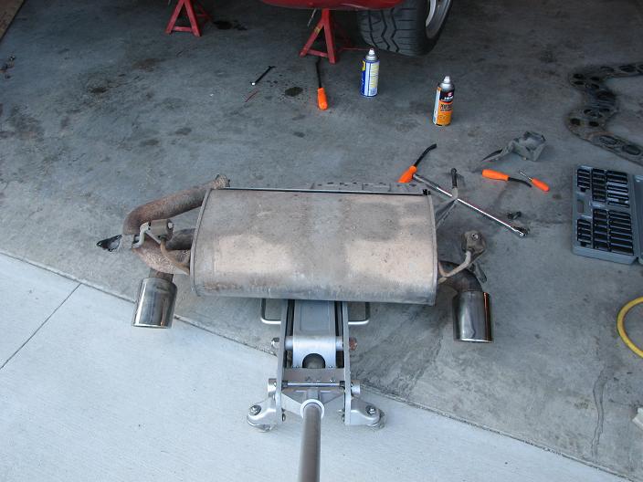

Injen05.jpg - That stock muffler's HUGE! I couldn't get the hangers off, so I had to take a couple parts off to access and take off the brackets. Make sure you put the jack under the exhaust before unbolting the brackets.

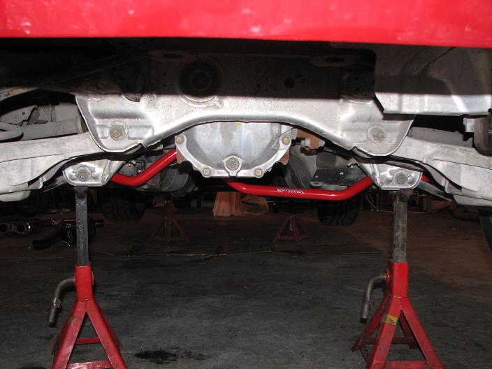

Injen06.jpg - I figured this was an opportunity to install the Hotchkis rear sway bar.
At this point, it was getting late, and I put down the camera to get the job done. The pipes went in with some effort, which apparently is normal when working with exhausts. I had a lot of trouble aligning the tips... partly because of the missing bracket I referred to earlier. [B]Does anyone know if Injen was supposed to supply that bracket, or if Nissan has a bracket for the passenger-side mid-pipe?[\B] After about an hour of swearing, I managed to tighten everything up without anything touching, but still not aligned. The next morning I took it into Fast Lane on Regent. They put it up on the lift and did a great job getting it aligned fairly well. One guy held the piping, and the other cinched it down tight with an impact gun.
Injen07 & 08.jpg - The end result. Looks good, but the right side is a little wonky still, because of the missing bracket.
