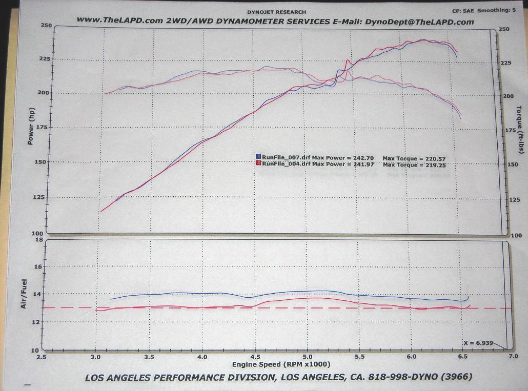

Well, I just got back and....well...if i just go by the dyno alone i'm worst off than before..LOL. but there is hope. (again i'll scan the graph and post them up asap)
my mods before-Stillen duals, motordyne 5/16 iso thermal, k and n intake, kjr pulley:
basically my best peak #s last time were 241.97whp 219.25lbs tq. now my peak #s are 242.70whp and 220.57lbs. of tq. but it gets worse. looking at the curve it looks like this:
3.0-3.5K rpm= +0whp +0 tq
3.5-4.0K rpm= +3whp +5 tq
4.0-4.5K rpm= +2whp +3 tq
4.5-4.8K rpm= +3whp +3 tq
4.8-5.0K rpm= -3whp -3 tq
5.0-5.5K rpm= -5whp -5 tq
5.5-6.0K rpm= -6whp -6 tq
6.0-6.1K rpm= -3whp -3 tq
6.1-6.2k rpm= +1whp +1 tq <---peak power
then it kinda just dies from there. Am I surprised? not too much. i was hoping i wouldn't have to tune to squeeze out power but looking at the a/fs it looks like i'll have to.
that's where there is hope. my last dyno without the headers showed an a/f ratio at 13 flat straight across till 4.5-5.5K where it bliped to 13.8 than came down to 13 flat again.
now with the headers i'm running really lean showing almost 14s across the rpm range!
i think that's where i can squeeze off more power. a good tune. i richen up a bit back to 13s-13.5 and i'll be seeing the power that i'm supposed to.
so waste of money? i don't think so. it just reaffirms what i already know. a good n/a set up needs a tune. during everyday driving at part throttle i do notice a difference in tq. it's not like i don't like my headers...it's just now i'm going to have to tune to get the most out of them. plus the car does sound more throaty.

Default Just got my dyno scanned...
here's the dyno....notice how lean i am throughout the band after the headers and that i actually lose more power than i gain. time for a tune...
i think this is the first baseline vs dc header. i haven't seen one on these boards from an independant source yet.

looks like your car goes a little funky around 5400rpm. I'm interested in seeing what a tune will do for you
hopefully the lackluster power is due to not having enough fuel. i hope to richen up and see power thoughout the band when i do a tune. it's very hard to get an appointment at technosquare because i work on the weekdays (the only time they are open). i can send my ecu out but since i live in socal i would want them to tune accordingly with a dyno or mobile afr sensor.

i was thinking maybe my ecu needed to adjust...but i doubt it. i had the headers a full week before the dyno with some wot runs here and there.
Which is before and after? Red or blue?
umm...dyno runfile.04 would be before (red) and dyno runfile.07 would be after (blue). it basically stops making more power than the last dyno after 4.5-4.8K rpm and starts losing it.
Decreasing the air:fuel ratio with a tune will be interesting.
