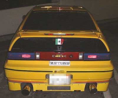

Originally posted by Heat
Theres that word again, RICE. Jeez is every mod considered "rice" on these forums.
I don't get it either Heat.
Although I do like the Injen exhaust, I can say the tips on this exhaust are better looking.
Here's a real example of rice, OK!
