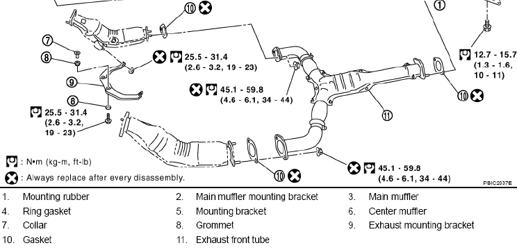

can anyone tell me the part number for this part

I dont know the exact name but its that U shapped mount that holds the two factory cats in place so it doesn't move turning movement and torque of the motor. It's located right under the tranny. Last i remember its a something mount. Can anyone help?

part #9
exhuast mounting bracket
kind of a generic sounding name
Attached Thumbnails can anyone tell me the part number for this part-bracket.jpg
