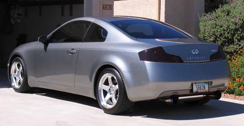

I disagree. It's the Invidia for me. The Invidia keeps the muffler in the same location as stock, whereas the Injen leaves a big hole where the muffler was thereby disturbing the underside aerodynamics.
Lou
Attached Thumbnails injen ti vs. invidia g200-h-pipe0.jpg   injen ti vs. invidia g200-painted-bumper0.jpg

I really didn't either, until I added the "H" pipe. The Invidia is a real dual system, with separate chambers in the muffler. It needs an "H" or "X" pipe to balance the two sides. Without the "H", at idle it sounded like 2 three cylinder engines both in and out of the car. After the addition of the "H" everything smoothed out. The sound is now, IMHO, fantastic. Very smooth at idle and it bellows at WOT.
